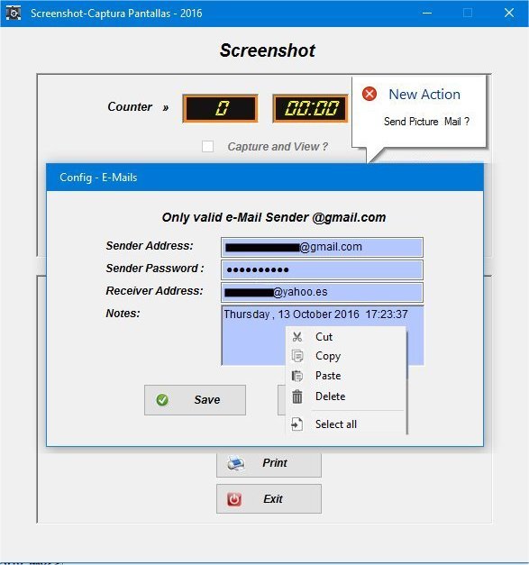

El Maestro me mandó unas muestras de código Fuente
para correo , pero lamento mi ignoracia no he sabido
interpretar, me acordé que DaNiElMaXiMiLiAnO hace
algun tiempo había publicado un sample para mandar
correo y he recogido una parte de su Sample, para
implemntar mi experimento.
"CDOsys sending email" -> http://hmgforum.com/viewtopic.php?f=24&t=3473
Mis conocimientos son muy escasos referente al Servidores
de Correo Saliente y de Puertos , he probado con
Gmail y veo que está funcionando y he fracasado con
Yahoo creo que es un problema de permisos Ver "Help_06_MAIL.jpg"
en Carpeta de la aplicación "Screenshot_Help".
Tambien he creado un Contador inverso para las capturas
es Opcional.

My knowledge is very scarce concerning the Servers
and Outgoing Mail Ports, I tested with
Gmail and see that it's working and I have failed to
Yahoo think it's a permissions problem See "Help_06_MAIL.jpg"
Folder, "Screenshot_Help" application.
I have also created a reverse counter for catches
It is optional.

    Errors:
    I see sometimes fails especially if loaded
    for viewing, some file ".jpg", not so
    Same with "Png". (I have not been able to find solution)
6.- Connection Error: e-Mails
    Habeces appears similar to this mesaje and of course
    "hangs" the program did not if it's because I've been
    doing tests sending mail to Yahoo ???
WINOLE / 1007 Error Could not send the message to the SMTP server.
The error code was 0x80040217 transport.
The server response was not available (0x80040211): SEND (DOS Error -2147352567)
