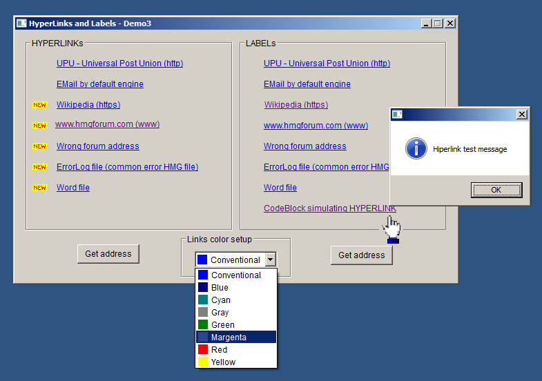

Hi Rathi and all,
I would like to add more one example for C:\hmg.3.4.3\SAMPLES\Advanced\USER_COMPONENTS.
This time some USER definition for HYPERLINKs and LABELs simulating hyperlink. This example contemplates chnging visual link color when be clicked (as normal browsers does) and address links now it could be for https, www, ErrorLog file (which is in html format), Word files by explorer association or any other document. Of course this example uses a differentiated i_UsrInit.ch file.
I've attached all files for your appreciation.
Hope everyone enjoys
