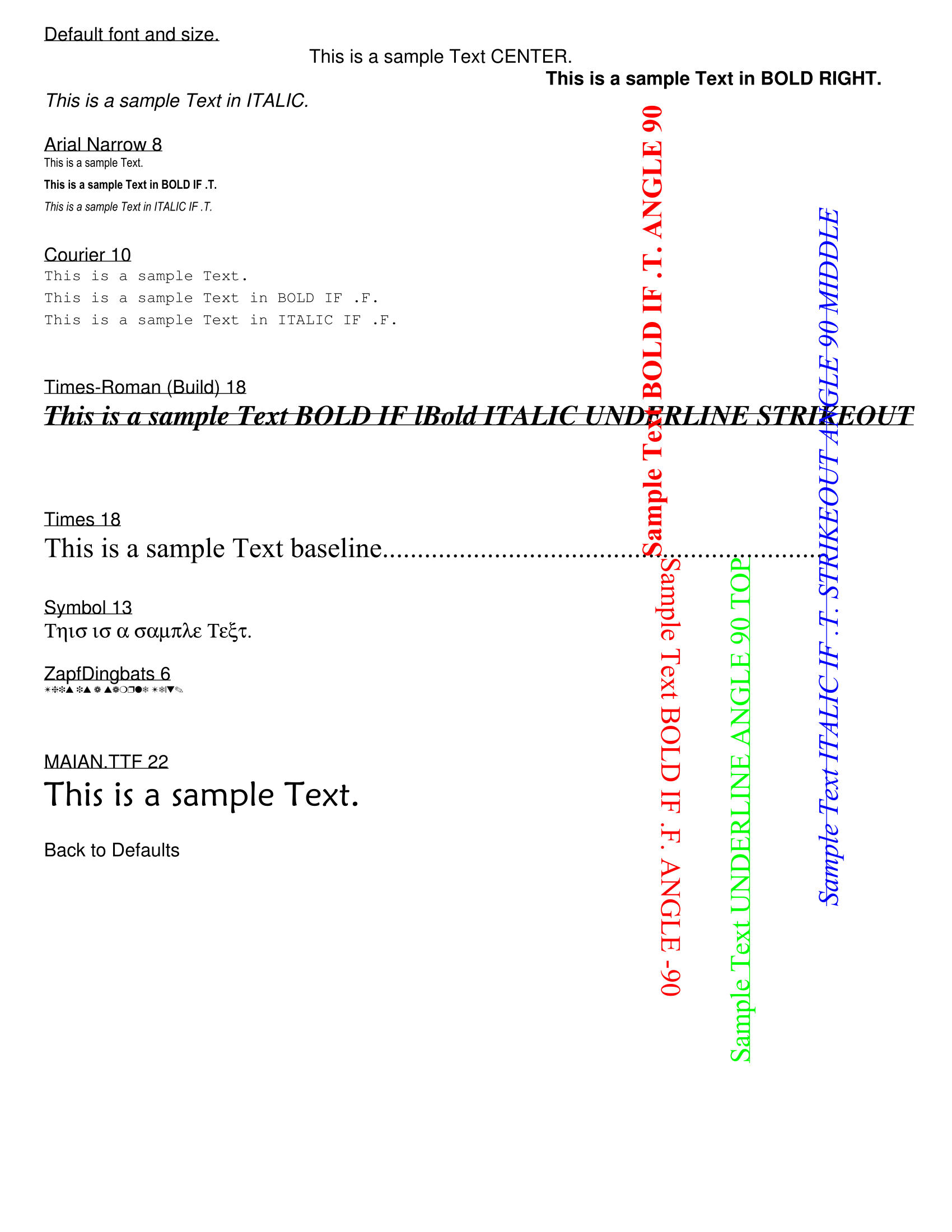

New features:
HMG HPDF
HPDFPRINT command improvements:
- UNDERLINE style support added (simulation).
- STRIKEOUT style support added (simulation).
- ANGLE <nAngle> attribute has been added - text rotation by angle <nAngle>
- TOP | MIDDLE vertical alignment style has been added for the ANGLE attribute
- optionally define styles BOLD | ITALIC | UNDERLINE | STRIKEOUT has been added - optional attribute IF <lValid>
New commands:
- SET HPDFDOC FONT NAME TO <cFontName> - set the default font as <cFontName>.
- SET HPDFDOC FONT SIZE TO <nFontSize> - set the default font size to <nFontSize>.
Removal of noticed bugs.
Sample:
#include "harupdf.ch"
Function Main()
SELECT HPDFDOC "sample.pdf" PAPERLENGTH 300 PAPERWIDTH 300 LOG
START HPDFDOC
	START HPDFPAGE
		SET HPDFDOC ENCODING TO "WinAnsiEncoding"
		@  5, 10 HPDFPRINT "Default font and size." UNDERLINE
		@ 10,100 HPDFPRINT "This is a sample Text CENTER." CENTER
		@ 15,200 HPDFPRINT "This is a sample Text in BOLD RIGHT." BOLD RIGHT
		@ 20, 10 HPDFPRINT "This is a sample Text in ITALIC." ITALIC
		SET HPDFDOC FONT SIZE TO 8
		SET HPDFDOC FONT NAME TO "Arial Narrow"
		@ 30, 10 HPDFPRINT "Arial Narrow 8" FONT "Helvetica" SIZE 12 UNDERLINE IF .T.
		@ 35, 10 HPDFPRINT "This is a sample Text."
		@ 40, 10 HPDFPRINT "This is a sample Text in BOLD IF .T." BOLD IF .T.
		@ 45, 10 HPDFPRINT "This is a sample Text in ITALIC IF .T. " ITALIC IF .T.
		SET HPDFDOC FONT SIZE TO 10
		SET HPDFDOC FONT NAME TO "Courier"
		@ 55, 10 HPDFPRINT "Courier 10" FONT "Helvetica" SIZE 12 UNDERLINE
		@ 60, 10 HPDFPRINT "This is a sample Text."
		@ 65, 10 HPDFPRINT "This is a sample Text in BOLD IF .F." BOLD IF .F.
		@ 70, 10 HPDFPRINT "This is a sample Text in ITALIC IF .F." ITALIC IF .F.
		SET HPDFDOC FONT SIZE TO 18
		SET HPDFDOC FONT NAME TO "Times-Roman"
		lBold := .T.
		@ 85, 10 HPDFPRINT "Times-Roman (built-in) 18" FONT "Helvetica" SIZE 12 UNDERLINE STRIKEOUT IF .F.
		@ 90, 10 HPDFPRINT "This is a sample Text BOLD IF lBold ITALIC UNDERLINE STRIKEOUT" BOLD IF lBold ITALIC UNDERLINE STRIKEOUT
		SET HPDFDOC FONT NAME TO "Times"
		@ 115, 10 HPDFPRINT "Times 18" FONT "Helvetica" SIZE 12 UNDERLINE
		@ 120, 10 HPDFPRINT "This is a sample Text baseline................................................................"
		@ 120, 150 HPDFPRINT "Sample Text BOLD IF .T. ANGLE 90" BOLD IF .T. COLOR {255,0,0} ANGLE 90
		@ 120, 150 HPDFPRINT "Sample Text BOLD IF .F. ANGLE -90" BOLD IF .F. COLOR {255,0,0} ANGLE -90
		@ 120, 170 HPDFPRINT "Sample Text UNDERLINE ANGLE 90 TOP" UNDERLINE COLOR {0,255,0} ANGLE 90 TOP
		@ 120, 190 HPDFPRINT "Sample Text ITALIC IF .T. STRIKEOUT ANGLE 90 MIDDLE" ITALIC IF .T. STRIKEOUT COLOR {0,0,255} ANGLE 90 MIDDLE
		SET HPDFDOC FONT SIZE TO 13
		SET HPDFDOC FONT NAME TO "Symbol"
		@ 135, 10 HPDFPRINT "Symbol 13" FONT "Helvetica" SIZE 12 UNDERLINE
		@ 140, 10 HPDFPRINT "This is a sample Text."
		SET HPDFDOC FONT SIZE TO 6
		SET HPDFDOC FONT NAME TO "ZapfDingbats"
		@ 150, 10 HPDFPRINT "ZapfDingbats 6" FONT "Helvetica" SIZE 12 UNDERLINE
		@ 155, 10 HPDFPRINT "This is a sample Text."
		SET HPDFDOC FONT SIZE TO 22
		SET HPDFDOC FONT NAME TO "MAIAN.TTF"
		@ 170, 10 HPDFPRINT "MAIAN.TTF 22" FONT "Helvetica" SIZE 12 UNDERLINE
		@ 175, 10 HPDFPRINT "This is a sample Text."
		@ 190, 10 HPDFPRINT "Back to Defaults"
	END HPDFPAGE
END HPDFDOC
Execute File 'sample.pdf'
PRINT SYSTEM
		@ 115, 10 PRINT "Times 18" FONT "Helvetica" SIZE 12 UNDERLINE
		@ 120, 10 PRINT "This is a sample Text baseline................................................................"
		@ 120, 150 PRINT "Sample Text BOLD IF .T. ANGLE 90" BOLD IF .T. COLOR {255,0,0} ANGLE 90
		@ 120, 150 PRINT "Sample Text BOLD IF .F. ANGLE -90" BOLD IF .F. COLOR {255,0,0} ANGLE -90
		@ 120, 170 PRINT "Sample Text UNDERLINE ANGLE 90 TOP" UNDERLINE COLOR {0,255,0} ANGLE 90 TOP
		@ 120, 190 PRINT "Sample Text ITALIC IF .T. STRIKEOUT ANGLE 90 MIDDLE" ITALIC IF .T. STRIKEOUT COLOR {0,0,255} ANGLE 90 MIDDLE
		@ 135, 10 PRINT "Symbol 13" FONT "Helvetica" SIZE 12 UNDERLINE
		@ 140, 10 PRINT "This is a sample Text."
		@ 150, 10 PRINT "ZapfDingbats 6" FONT "Helvetica" SIZE 12 UNDERLINE
		@ 155, 10 PRINT "This is a sample Text."
		@ 170, 10 PRINT "MAIAN.TTF 22" FONT "Helvetica" SIZE 12 UNDERLINE
		@ 175, 10 PRINT "This is a sample Text."
		@ 190, 10 PRINT "Back to Defaults"
	END PRINTPAGE
END PRINTDOC

- <xData> type can be character, numeric, date, logical or memo.
- Logical data is shown as 'Yes' or 'No' (translated according selected language).
- If <xData> is multi-line text (character or memo types), you must specify TO <nToRow> , <nToCol> optional parameters.
- When <xData> type is numeric, digits are printed begining exactly at specified position (without leading spaces).
- If optional RIGHT clause is used <Row> , <Col> indicates the right coordinates of <xData> (unless TO <nToRow> , <nToCol> is specified.)
- If optional CENTER clause is used <Row> , <Col> indicates the center coordinates of <xData> (unless TO <nToRow> , <nToCol> is specified.)
- If optional IF clause for the styles: BOLD | ITALIC | UNDERLINE | STRIKEOUT is used, then the style will be active when the expression given after IF return "true".
- Support for the UNDERLINE and STRIKEOUT style for PDF has been added. (Style simulation). (Unless TO <nToRow> , <nToCol> is specified.)
- Support for the ANGLE rotation for PDF has been added. (Unless TO <nToRow> , <nToCol> is specified.)
- If optional TOP clause is used <Row> , <Col> indicates the top coordinates of rotated <xData> (unless TO <nToRow> , <nToCol> is specified) (only supported by SELECT PRINTER PDF <PDF File> TO <Success>).
- If optional MIDDLE clause is used <Row> , <Col> indicates the middle coordinates of rotated <xData> (unless TO <nToRow> , <nToCol> is specified.) (only supported by SELECT PRINTER PDF <PDF File> TO <Success>).
Units: <Row> , <Col> units are milimeters.
Sample:
@ 10, 10 PRINT "Test BOLD" FONT "Arial" SIZE 10 BOLD IF lBold ITALIC
Prints "Test BOLD" as italicised and bolded, when lBold is "true".
========================================================== HMG HPDF
HPDFPRINT Prints Data
@ <Row> , <Col> HPDFPRINT [ DATA ] <xData>
[ TO <nToRow> , <nToCol> ]
[ FONT <cFontName> ]
[ SIZE <nFontSize> ]
[ BOLD [ IF lBold ] ]
[ ITALIC [ IF lItalic ] ]
[ UNDERLINE [ IF lUnderline ] ]
[ STRIKEOUT [ IF lStrikeout ] ]
[ COLOR <aColor> ]
[ RIGHT | CENTER | JUSTIFY]
[ ANGLE <nAngleInDegrees> ]
[ TOP | MIDDLE ]
- Optional JUSTIFY clause is valid when TO <nToRow> , <nToCol> is specified.
- Support for the UNDERLINE and STRIKEOUT style has been added. (Style simulation). (Unless TO <nToRow> , <nToCol> is specified.)
- Support for the ANGLE rotation has been added. (Unless TO <nToRow> , <nToCol> is specified.)
Sample:
@ 10, 10 HPDFPRINT "Test BOLD" FONT "Arial" SIZE 10 BOLD IF lBold ITALIC
