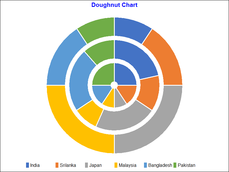

Here is an update!
- New Graph Type Doughnut
- Color palette selector, Doughnut hole size slider in Demo

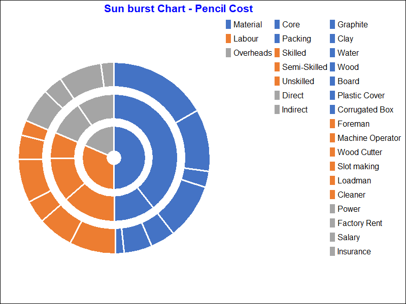

Another dream came true with Sun Burst Chart which can represent Hierarchical Data (like Group-> Sub-Group->Head->Value )
For Sun Burst Chart, legends position in the right looks good and logical as seen below:

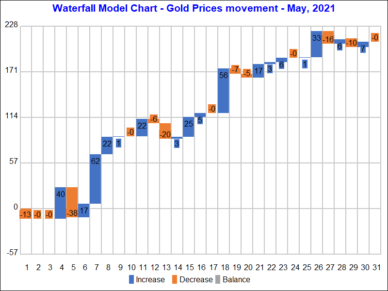

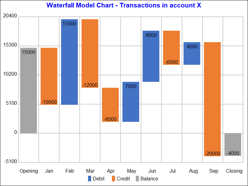

Here comes the next update:
- New Graph type Waterfall Model (Useful to show price change/Flow)
