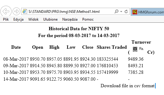

Unfortunately I can't download the file "CSV" (from the link in the corner), because the link executes the script on the server, I can't run it.
However, I'm thinking that the downloaded html table by my program will allow you to easily obtain the datas.
PS. Especially in the program I used two methods to obtain data to show (teach) how this can be done.
The first method uses OLE, the second uses hbTIP.
Edward.

Hi Edward,
Many thanks for the program. You are just great !. :ugeek:
I can download the index information from nseindia website now. :D
The information is in html format. Can you please tell me a way to read this file and import the information in preferably CSV file. :?:

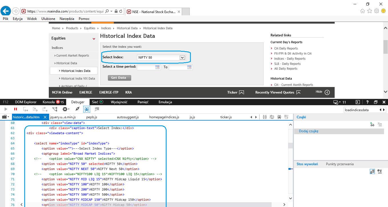

The queries depends of host. Different query is for Google and others for Yahoo, and others for each host.
You need to analyze the code html web pages for which you want to query. Or look for information from the webmaster to send queries.

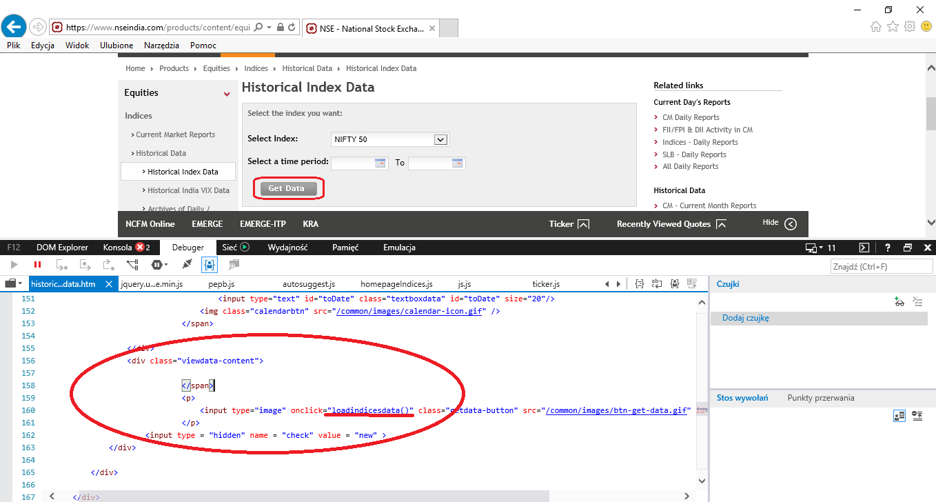

If you examine the code html https://www.nseindia.com/products/conte ... x_data.htm, you'll see what doing the "get data" button :-)
Apart from that, some hosts may need to define headers. Look for tools for html packet capture and see what the browser sends to the host.
Edward.
Indexes list:

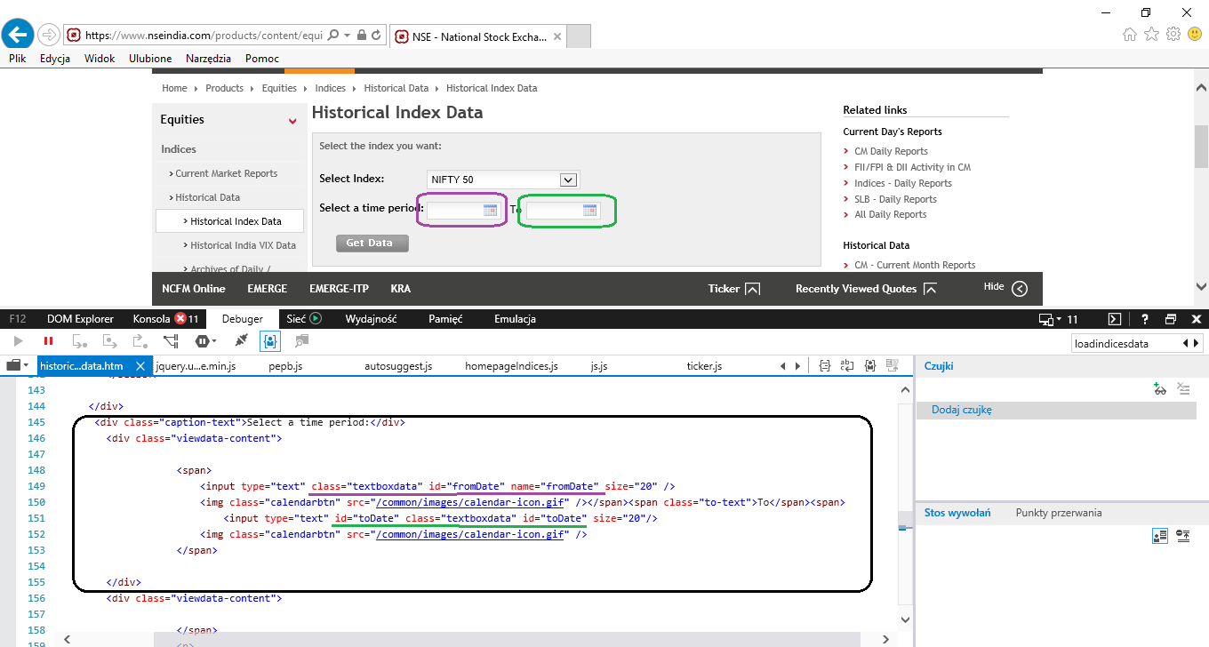

Dates:
"Get Data":

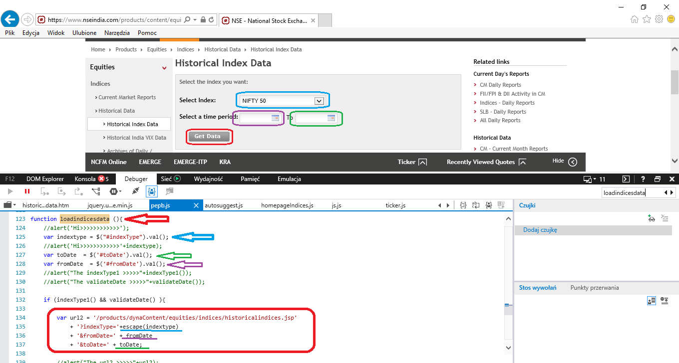

The query:
Note the & sign.
In Clipper you can not use it directly because it will be interpreted as a macro. Therefore, it occurs separately: "&" + "fromDate" instead of "&fromDate".
