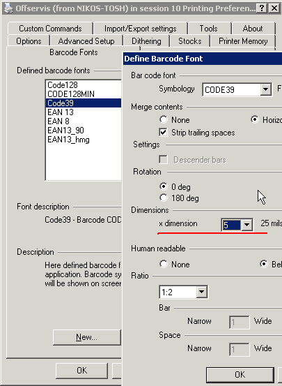

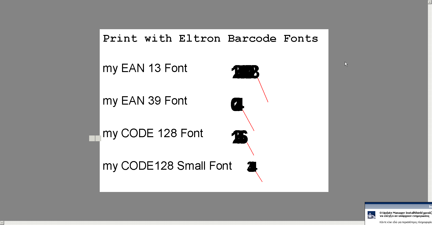

There is a problem with the print preview. There is no space between the letters.
Of course if we enlarge the x dimension of the driver enlarges the distance between letters but naturally also enlarges the x dimension of the barcode…
How could we solve this? (IE to enlarge the spacing of letters without enlarges the barcode...)

Because the problem is only in preview and not in printing, I think that is not so important..

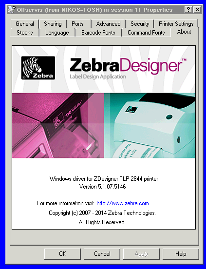

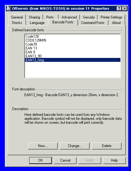

Hi Mol,
If you got this driver
and you have create your fonts that you see here
if the preview is something like this
and you barcode print is so bad, then something does not go well.
Because I print barcode code128 1 cm wide and look perfect.
Can you send me please your code for print with my own printer?
- preview.PNG (51.64 KiB) Viewed 6259 times
- fonts.png (13.57 KiB) Viewed 6262 times
- version.png (59.75 KiB) Viewed 6262 times
