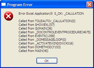

I found some following error during running my changed software :-
I found that it is due to the statement:-
	oExcel:Calulation := xlManual
My changed code is given here
Demo.zip
(1.5 KiB) Downloaded 900 times

Posts: 3805
Re: How to Export to Excel
Hello Sudip!
Have you seen that you (and me) wrote "CALULATION" not "CALCULATION" !!!
This is the reason of error.
I found it later.
It was casued due haste...
Marek

Hi Marek,
Thanks it's now OK :D And exporting large table becomes very quick :D
Thank you very much :D
