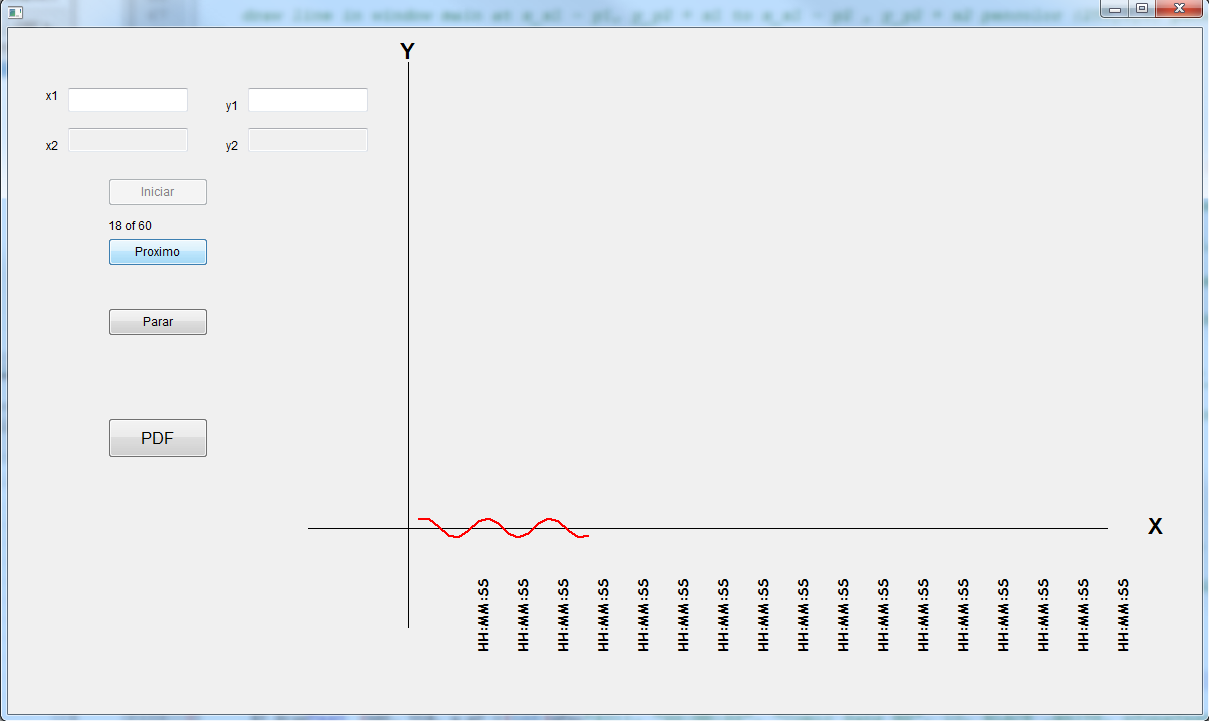

Thank you, KDJ, exactly.
nTypeText := BT_TEXT_OPAQUE + BT_TEXT_BOLD + BT_TEXT_ITALIC + BT_TEXT_UNDERLINE
nAlingText := BT_TEXT_CENTER + BT_TEXT_BASELINE
nOrientation := 90
BT_DrawText (hDC, 300, 400, " The Power of HMG 1", "Comic Sans MS", 42, WHITE, BLACK, nTypeText, nAlingText, nOrientation)
Jair Pinho
HMG ALTA REVOLUÇÃO xBASE
HMG xBASE REVOLUTION HIGH
http://www.hmgforum.com.br
jairpinho
Posts: 420
Re: label at runtime
Post by jairpinho »
this is the result, now I just need to do this in pdf.

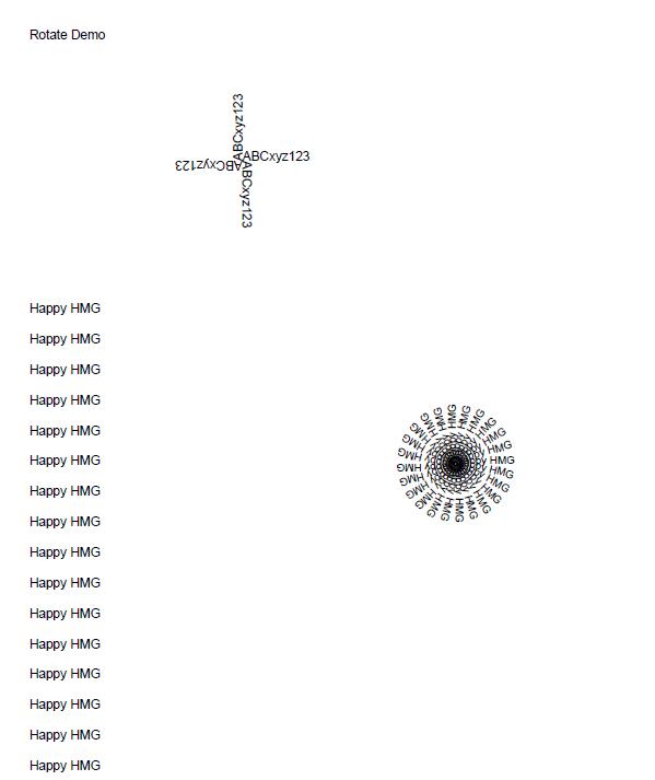

I hope this will be helpful:
Function Main()
Local i
SELECT HPDFDOC "sample.pdf" PAPERLENGTH 300 PAPERWIDTH 300 LOG
SET HPDFDOC ENCODING TO "WinAnsiEncoding"
START HPDFDOC
    START HPDFPAGE
	@10,10 HPDFPRINT "Rotate Demo"
        HPDF_RotateText( 50, 80, "ABCxyz123", Nil, Nil, 90 )
	HPDF_RotateText( 50, 80, "ABCxyz123", Nil, Nil, 180)
        HPDF_RotateText( 50, 80, "ABCxyz123", Nil, Nil, 270)
	HPDF_RotateText( 50, 80, "ABCxyz123", Nil, Nil, 0 )
	FOR i=100 TO 300 STEP 10
		@i,10 HPDFPRINt "Happy HMG"
	NEXT i
	FOR i=0 To 345 STEP 15
		HPDF_RotateText( 150, 150, "Happy HMG", Nil, 10, i )
	NEXT i
    END HPDFPAGE
END HPDFDOC
Execute File 'sample.pdf'

EDK thanks for the function you created to rotate the text in pdf
now and the graph in pdf the text is ok

Corrected. I added font attributes, and colors.
By the way, I found a bug in the source h_HMG_HPDF.Prg
If you want to use the Bold and/or Italic attributes you need to add in h_HMG_HPDF.Prg at line #1812: cFnt := cFont (after "Otherwise"). Otherwise, cFnt variable for declared cFont: "Courier" and "Helvetica" is Nil value, which results in an error.
After the change, of course, you have to rebuild the HMG.

      VALTYPE( aColors[1] )#'N' .OR. VALTYPE( aColors[2] )#'N' .OR. VALTYPE( aColors[3] )#'N' .OR. ;
      aColors[1]<0 .OR. aColors[1]>255 .OR. ;
      aColors[2]<0 .OR. aColors[2]>255 .OR. ;
      aColors[3]<0 .OR. aColors[3]>255
      aColors     := { 0, 0, 0}
   Endif
   HPDF_Page_SetRGBFill( hPage, aColors[1]/255, aColors[2]/255, aColors[3]/255 )
   // set font
   If HMG_LEN( AllTrim( cFont ) ) == 0
      cFont := _HMG_HPDF_SetFont( cFont, lBold, lItalic )
      oFont := HPDF_GetFont( hPdf, cFont, cPdfEnc )
      cFont := AllTrim(_HMG_HPDF_SetFont( cFont, lBold, lItalic ))
      if HMG_UPPER (cFileExt (cFont)) == '.TTF' // load ttf font
         cFnt := HPDF_LOADTTFONTFROMFILE( hPdf, cFont, .t. )
         If HMG_LEN( Alltrim( cFnt ) ) == 0
            _HMG_HPDF_Error( 6 , cFont )
         oFont := HPDF_GetFont( hPdf, cFnt, cPdfEnc )
         If HMG_UPPER( alltrim( cFont ) ) == "SYMBOL" .or. HMG_UPPER( alltrim( cFont ) ) == "ZAPFDINGBATS"
            oFont := HPDF_GetFont( hPdf, cFont, Nil )
         endIf
   endIf
   If oFont == Nil
   Endif
   HPDF_Page_SetFontAndSize( hPage, oFont, nFontSize )
   nTextWidth := HPDF_Page_TextWidth( hPage, cTxt )
   nRad := nAngle / 180 * 3.141592 	//radian value
   HPDF_Page_BeginText( hPage )
   HPDF_Page_SetTextMatrix ( hPage, cos ( nRad ), sin ( nRad ), -sin ( nRad ), cos ( nRad ), nxPos , nyPos - nFontSize)
   HPDF_Page_ShowText( hPage, cTxt )
   HPDF_Page_EndText( hPage )
Posts: 3348
Please note:
cFnt := cFont
instead of
cFnt: = cFont
