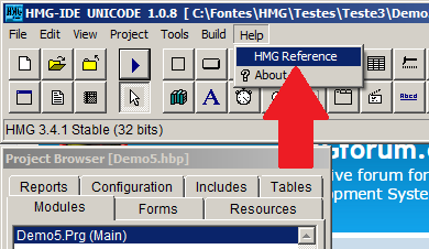

Clip2Mania wrote:Suggestion: The HMG_CallDLL() function is not yet included in the forum documentation hmgdoc/data/index.htm. the old CallDLL32 is still there.
Hi Erik,
You are right ! Our hmgdoc at hosted is not updated, Mr. Rathinagiri is being advised to provide for us.
Because ou lasted HMG version is already updated which one you can access by our IDE at:
This will access in your HMG installed pack.
Thank you Erik for advising us. :)

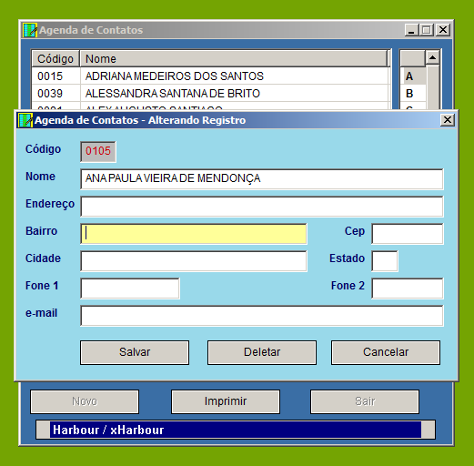

Fixed and enhanced SAMPLES
Hi Rathinagiri,
In C:\hmg.3.4.3\SAMPLES\Applications\AGENDA the source code sample was changed event in GRID to work more eficiently. Please note following code for your evaluation of replacement to next version:
Added later in red:
<Source code has removed because there is a newest version below>
Was added two new functions. Basically one is for typing control as a kind of MASK. Usefull for fields like telephone number, zip codes or any document with mask filling. In this demo, these masks can be tested in "Cep" field adding a slash in the 6th position automatically and in "Estado" field which fill up automactically according aEstado array.
Another function check as a VALID after filling field.
In original code LABELs were with so big sizes and was making impossible to make focus by mouse in fields: Cep, Estado and Fone. So it was corrected to work in good order.
I know this example could it make better. Feel you free for improvings and use what you need it. Enjoy ! :)
Added later in red:
Rathinagiri wrote:Thank you Pablo.
You are welcome for you and for everybody that might interest it. :)
Have you tested already? At double-click in main grid, try to fill up fields "Estado" (with "B" fo Bahia "PX" for wrong state) and "Cep" ("12345-678" for slash autocomplete case).
Are nice samples, quite similar Clipper's routines effects... but probably useful for others may implement in GUI programming. It serves as learning material.
I do not know if HMG managers have interest for improvements in our SAMPLES\Demos :?:
Because I always see the chance for enriching examples and share with colleagues.
In this demo (C:\hmg.3.4.3\SAMPLES\Applications\AGENDA), I have add other two new functions:
ChngColorField(), which is in charge to change texbox backcolor when is focused
and EnabledThis(), recently I saw there was not possible to change fontcolor in textbox when are not Enabled :| then tis function do not allow user to make focus (simple solution).
See AGENDA source code:

Was centralized animated file and with this it has been reponsed with the real WIDTH of this control.
I also changed background colors to become more beautiful screens.
Insert keys (HMG C functions) were utilized for moveto next fields and to erase wrong data.
Enjoy ! :)
