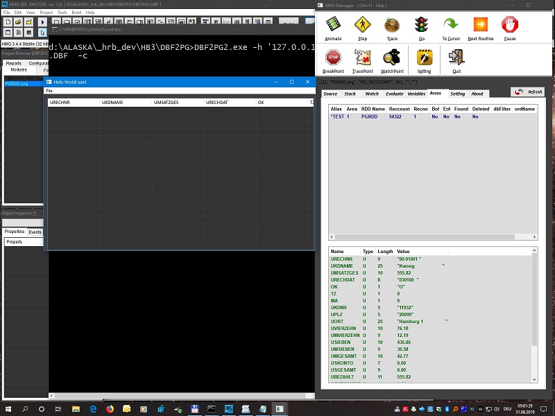

Empty GRID with \POSTGRESQL_1\demo.prg
i have modify Sample and transfer of DBF to PG-Table work. (test with PgAdmin)
now i want to show it but i get a Empty Grid ?

// hm ... why is it empty

sorry,
on top i have
REQUEST PGRDD
so App work now.
my Question is why GRID is Empty :o .
is that Syntax OK :?:
it show Header (aFields) and Column seem to have correct WIDTHS (aWidth).
as i say i have check new create Table (ANSI WIN1252) with PgAdmin.
i have modify code so it is limited e.g. UTF8 Table / Server as i use ANSI Win 1252.
do i need Unicode for GRID or can i use ANSI :?:
Posts: 2096
Re: how postgreSQL connect
this line seems correct while debugger show it under ALIAS
USE "SELECT * FROM "+cTable+" ;" ALIAS Test NEW VIA "pgrdd" CONNECTION nConnectionHandle
any Idee why GRID is still empty :?:

function update_grid()
local cQuery, nLimit
local nPos
// chage this line
*   cQuery:="SELECT * FROM test order by code"
// Table exist
    cQuery:="SELECT * FROM aaa4"
HMG Errorlog File
Date:08/31/19 Time: 07:53:48
Error: HMG 3.4.4 Stable (32 bits)
Grid.AddItem (nRowIndex = 1): Item size mismatch. Program Terminated
Called from _ADDGRIDROW(673)
Called from _ADDITEM(906)
Called from DOMETHOD(9265)
Called from UPDATE_GRID(117)
Called from MAIN(43)
jairpinho

hello, now you will start working and understanding about tables and grid in hmg:
SELECT * FROM test order by code == (*) will fetch all fields from table
If your aaa4 (7) table contains more fields than the test (5) table will give an error because when you use * in a select the pgSelectQuery () command returns all fields, so you have to change the properties in the grid headers. and widths
In this grid is defined as the table test 5 fields
Headers = {'Code', 'Name', 'Salary', 'Creation', 'Description'}
Widths = {100,100,100,100,100}
Your aaa4 table has the same number of grid fields if more error occurred
  You can select only the fields you need in this case in the example grid is prepared to receive up to 5 table fields if you need to modify the properties of the grid.
