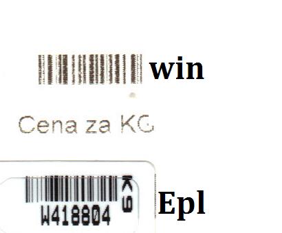

This setting exists also on Zebra TLP2844 but unfortunately it makes no difference to the final outcome of the barcode image printed.radohabjan wrote:Hello again,
I found out also the other solution, which is in printer driver graphics settings.
In my case : printer Xprinter has graphic setting Dithering, which must be None. Then is picture realy perfect (just black white).
br Rado
In the attached image you can see the difference between the barcode printing quality of the 2 methods.
- Labels_128.JPG (154.17 KiB) Viewed 6014 times
Best Regards,
Nikos.

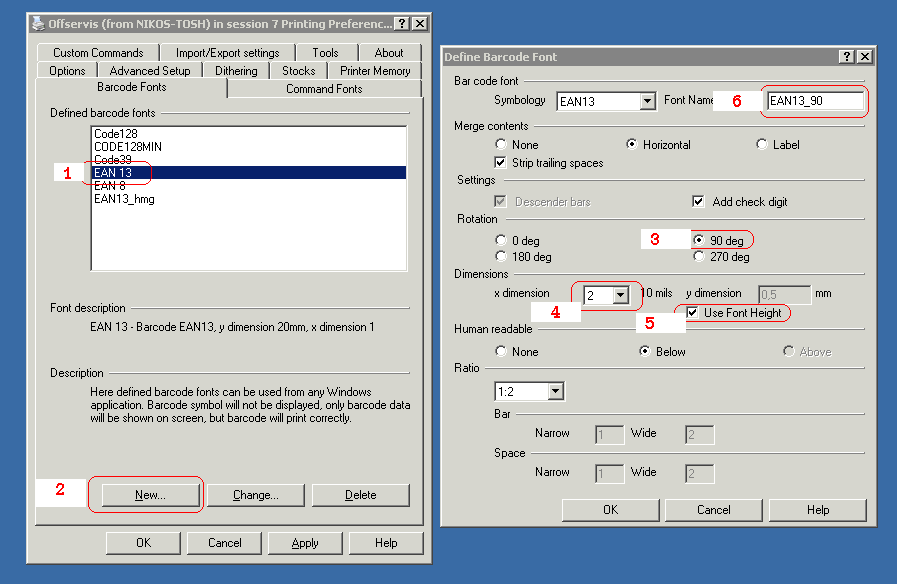

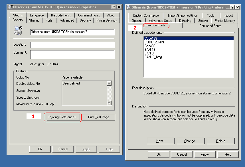

mol I found a solution for Windows: this is through the ZEBRA TLP2844 WINDOWS DRIVER (Ver 5.1.07.5146)
..., and in my opinion is very good for windows printing:
The Driver has built nearly all necessary barcode fonts used. You can create new fonts with the properties that you want to use within your program like regular Windows fonts:
E.g. If we want to create a perpendicular (90 °) EAN13 BARCODE with name EAN13_90.
We choose:
download/file.php?mode=view&id=5516
We choose:
download/file.php?mode=view&id=5517
In prg :
The following label font was created through the driver.
(we can also formulate and downloaded to the printer a ascii file with the printer driver settings. Also we can setup new fonts)
download/file.php?mode=view&id=5518
in prg:

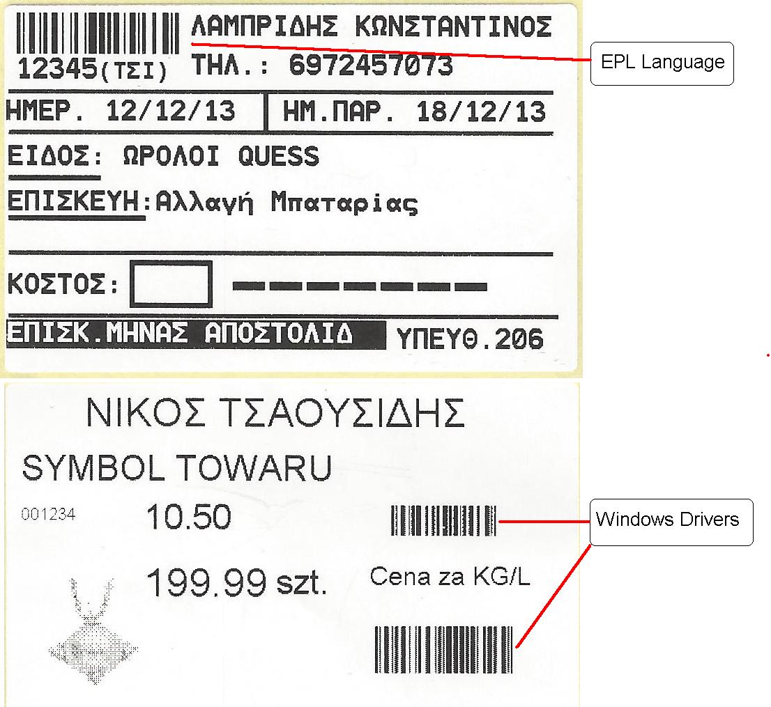

So far we have 2 pretty good solutions:
For windows the above, and dos & windows via EPL language: viewtopic.php?f=6&t=4131#p38879
If you try it, tell us your opinion
We choose:
We choose:
In prg :

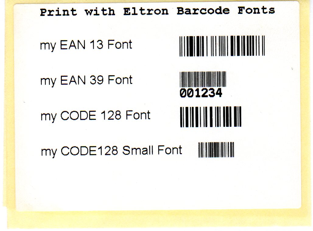

cValue := "1234567890123"
@ 10,40 PRINT cValue FONT "EAN13_90" SIZE 16 BOLD // created by myThe following label font was created through the driver.
in prg:
Function Print_page2()
SELECT PRINTER cPrinter ;
ORIENTATION PRINTER_ORIENT_PORTRAIT ;
PAPERSIZE PRINTER_PAPER_USER PAPERLENGTH 45 PAPERWIDTH 70;
QUALITY PRINTER_RES_MEDIUM ;
PREVIEW
START PRINTDOC
START PRINTPAGE
@ 1,1 PRINT "Print with Eltron Barcode Fonts " FONT "Courier New" SIZE 10 BOLD
@ 10,1 PRINT "my EAN 13 Font " FONT "ARIEL" SIZE 10
@ 10,40 PRINT "1234567890123" FONT "EAN13_hmg" SIZE 16 BOLD // created by my
@ 20,1 PRINT "my EAN 39 Font " FONT "ARIEL" SIZE 10
@ 20,40 PRINT "001234" FONT "Code39" SIZE 16 BOLD // already exist
@ 30,1 PRINT "my CODE 128 Font " FONT "ARIEL" SIZE 10
@ 30,40 PRINT "123456" FONT "Code128" SIZE 16 BOLD // already exist
@ 40,1 PRINT "my CODE128 Small Font " FONT "ARIEL" SIZE 10
@ 40,45 PRINT cPELATHSTXT5 FONT "CODE128MIN" SIZE 12 BOLD // created by my
END PRINTPAGE
END PRINTDOCSo far we have 2 pretty good solutions:
