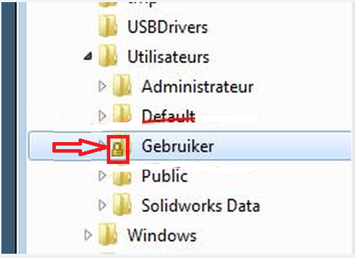

Serge,
The folder path/name is ok (I have a multi language PC!).
I have tried C:\users\Administrateur\ and others folders not in Gebruiker : no problem.
Now, I see a padlock on Gebruiker.
However, I can read/write in the files and subfolders of the folder Gebruiker.
But the access seems blocked (only) for my application : strange!
I have tried to unlock Gebruiker in the properties, without result : it remains locked.
I continue to search for the why.
Dominique

edk wrote: Fri Apr 06, 2018 4:16 pm Start application in "Run as Administrator" mode and check if you have access to this folder.
Hi edk,
I have already tried : it is the same.
He return 'My computer' and not the initpath.
Dominique

edk wrote: Tue Apr 10, 2018 11:47 am To which the user corresponds to the name "Gebruiker"? Will it be: Default, Default User, All Users, Public or is it called a local account in Windows?
What is the operating system?
Hi edk,
The OS is win7
The path is C:\Users\Gebruiker
The users are :
Getfolder() returns the initpath for all folders (and subfolders) except for the folder Gebruiker and its contents.
I have tried to unlock Gebruiker (10 minuts!) but the padlock stay there.
Dominique

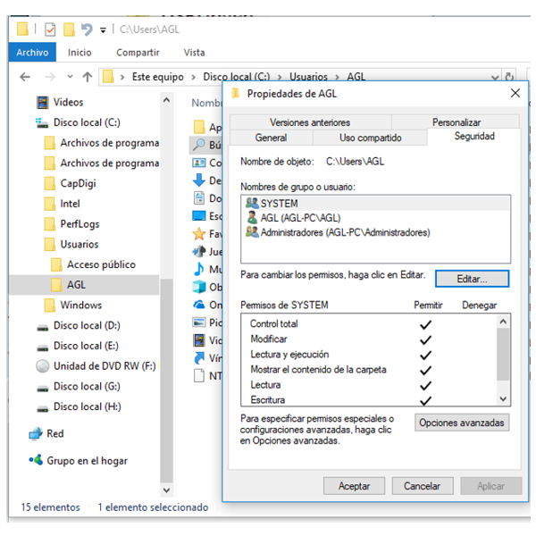

Re: Getfolder()
Tal vez en Seguridad...
En la carpeta oprimir Boton derecho / Propiedades / Seguridad
Maybe in Security ...
In the folder, click Right button / Properties / Security
