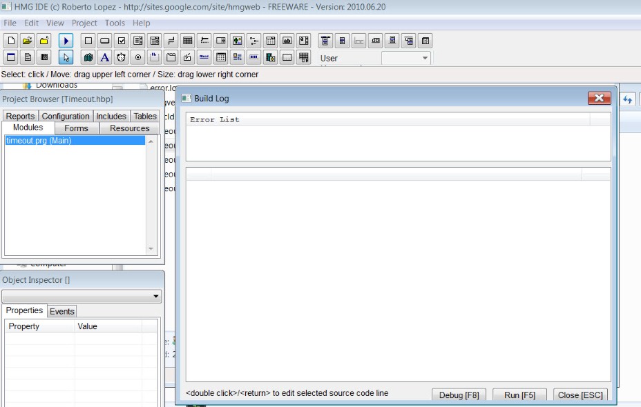

Hi esgici,
I compile with HMG.3.0.35 not pass and it show build log screen with blank Error list. No exe file created.
I need to use version 3.0.35 becase this version can use my local language.
Thank you

Apichit, this new MessageBoxTimeout function is made for UNICODE uses. There are some other ressources which you not find under 3.0.35 version.
apichit wrote:I need to use version 3.0.35 becase this version can use my local language.
But why are not using UNICODE version for your language too ? UNICODE supports all languages, it is how we use to read with one page of site in your browser. Totally transparent. If you finding out dificulties to adapt ANSI to UNICODE, I suggest you to start posting your doubts difficulties one by one. But UNICODE is the right way long for HMG, IMHO.
