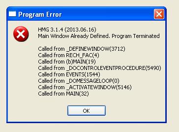

I already put and I copy my Rech_Fac.prg into SimpleGest\rech_fac directory.
NB: the RECH_fac.prg Works very good alone, but when I call it with RECHERCHE FACURE into the gestion14, I have problem with FILES.FMG
I dont undestand Why ?

Re: Migration from Clipper to HMG
OK, no problem my friend :)
maassalam
Hello Tabet
Anyway I have tried a bit help you.
Please look at attachment, this is unified version of your project.
But, excusez moi, this isn't the right way to learn.
Now, the error you notified ( "Can't open #include file 'Main.fmg'" ) (and fixed already by yo also ) eliminated.
But now you will be fatigued by searching answer to "where and how Esgici changed, and for what ?" question :(
My humble opinion is : instead of dealing with big projects, begin at the most beginning, the simple and simplest samples, and go forward step by step; if your main goal is learn.
gestion14(be).zip
Unified version of Gestion14 and Reach_Fac (source)
(63.68 KiB) Downloaded 515 times
