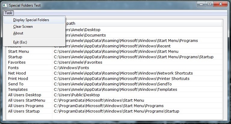

Hi
A little work to obtain paths of special folders of windows.
Thanks to inspiration by friend Dave :)
Screen shoot<br />  of Special Folders test prg
Screen shoot
SpFldTst.zip
Source files (.hbp, .prg) of Special Folders test prg
(2.95 KiB) Downloaded 533 times
