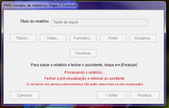

Master i´ve some little doubt about "Report Generator",
1-) When i add a Mask for one field, a don´t can remove this mask?! I try remove the mask but i not be able.
2-) When i click in "Preview" button and if my report have any error, this windows don´t close and don´t have the button for close that. So i can´t close that.
Please, about my 2st doubt, see the image bellow.
I have use HMG 3.0.0 Test XII,
Windows 7 Ultimate with Aero Theme
Celeron 3.06 Ghz, with 1GB RAM
My best regards,
PS: sorry my bad english.
Re: HMG 3.0 (Test XII)
Vanguarda wrote:Hi friends,
You are right. I've verified the two bugs.
One. An empty mask is not allowed, so you can't clean.
Two. If a runtime error arises in the preview report app (generated and compiled 'on the fly') the builder does not recover its buttons to return to IDE.
I'm working on the two problems.
Thanks for reporting.
