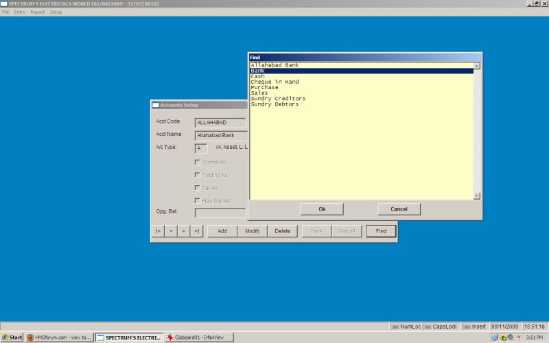

Hello Tristan,
I am only a learner of HMG :)
Some times ago I wrote a function which may solve your problem:
Following code may have bugs, but hope will help :)
wAcct.zip
(2.08 KiB) Downloaded 544 times
Please check FindRec() function :)
With best regards.
Sudip

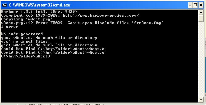

Hi Mr. Sudip,
Thanks for example, but I get error when compile.
Thanks,
Tristan

Hello Tristan,
I didn't send the total source code. I only showed you how to do this :)
Please check following code snippet :

Tristan wrote: Why use array not use direct table ? If use array all data should transfer to array, it takes time.
Because,
1) I want to make the code generic (please check FrmFind() function onwords). This code can be used with any table :)
2) This code can be used with SQL tables also where we store data into array :)
3) Generally Lookup table (in old days we called Master table) is not so big comparing Transaction table :)
4) I am a great admirer of GRID :) Please check VIRTUAL property of GRID in the Reference regarding performance :)
But, I can't say that I am always correct, as I am learning HMG ;)
So, please send your comments regarding this :)
