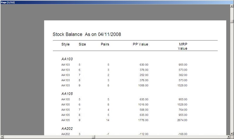

Today I created a test report as follows:
Here I use an array, aData. Rmg file is as follows:

I am not sure how I can add code in ITERATOR clause, because I have 3 fields for total. And, I have to re-initialize the sub total variables at the starting of each group (Heare Style, aData[1])
Thanks in advance.

Re: Report Generator
sudip wrote:Hello Master Roberto,
Thanks a lot.
The best way to give you more clues about this is to create a small, basic sample to show it you, but I have not enough time for that right now.
When possible, I'll post one.

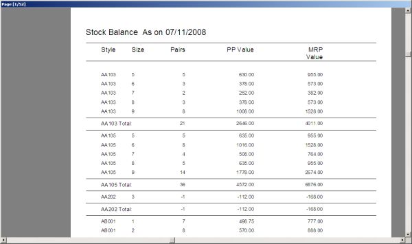

sudip wrote: <...>
If I've understood correctly, you can do it, using a function as iterator instead a single expression.
So, lets suppose that you use the following:
ITERATOR MyFunc()
The function will look as follows:
Function MyFunc()
i++
You must put here your accumulators for totals or subtotals.
You can compare current cycle values with previous ones to know if you must reset something.
To display the values you must specify them in expression's text property at group footer definition.
return nil
I hope that this helps.
Thanks a lot. It works :D
Only one point I have noticed. For groups if I use GROUPFOOTER, I have to specify BEGIN GROUPHEADER ... END GROUPHEADER, otherwise it will give runtime error. :)
