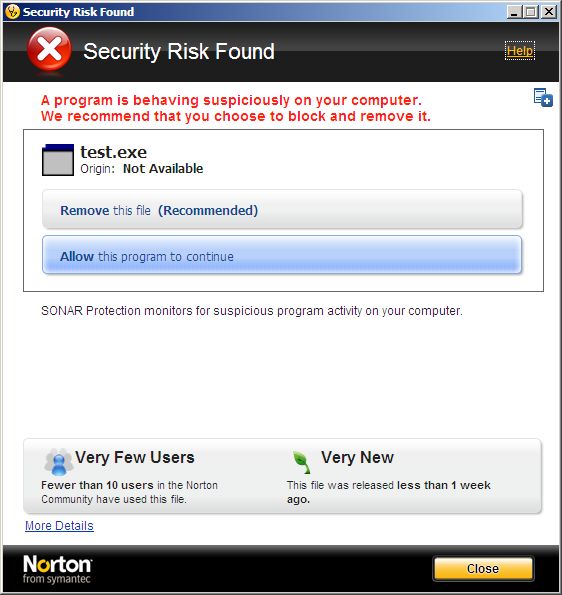

One thing I have noticed, there is a false alarm from my Norton Antivirus for created exe file (I tried many times). I never found this alarm from any application generated from HMG before, except I found a false alarm from Comodo antivirus for IDE.EXE file 4/5 months ago.
I recompiled same app with HMG295, but no warning found. I also didn't notice any problem with programs created with hmg3.0.0(IX) :)

I've answered the false alarm for you indicating that is related with Telock exe compressor.
Regarding this... I don't know :)

I just found an observation. When I use build.bat from command prompt NAV warning doesn't appear. So, it appears only when I use IDE :? I am 100% sure it's a false alarm. :lol:

IDE just calls build.bat, so... :)
