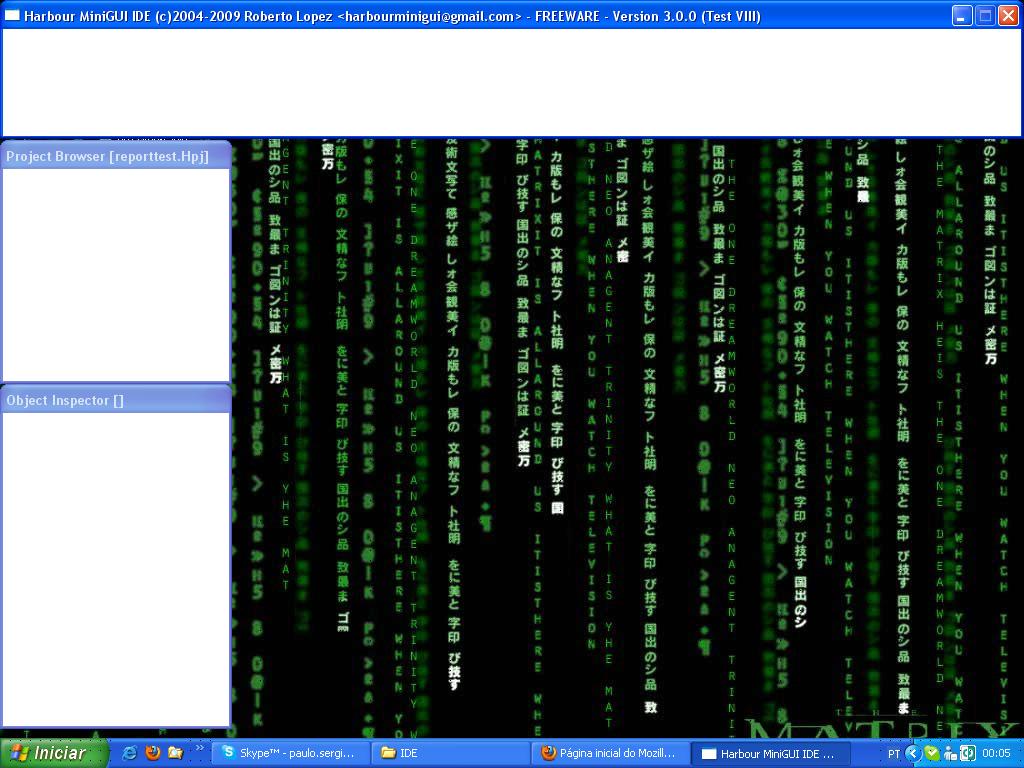

I´ve a little doubt about HMG-IDE. I did the download and opened the IDE, open the sample in "C:\hmg\IDE\samples\REPORT" and when i click in icone "New Report" and i click in "Cancel" button, the IDE was very slow for return. Please see the picture bellow. It could be a bug?

Vanguarda wrote: I´ve a little doubt about HMG-IDE. I did the download and opened the IDE, open the sample in "C:\hmg\IDE\samples\REPORT" and when i click in icone "New Report" and i click in "Cancel" button, the IDE was very slow for return. Please see the picture bellow. It could be a bug?
Yes. I've verified.
I try to find the cause.
Thanks for reporting.
Roberto.

Vanguarda wrote:Hello Master,
At first congratulations for your amazing work. I like very much the new structure of folders in new HMG version.
My Windows version is : Windows XP SP/2, with default theme. My computer is a Celeron(R) D 3.6Ghz with 1GB RAM.
Thanks for your attention.
With Best Regards,
Please, test:
ide_30_test_08_vanguarda_bug.rar
It has debugger support too.
Roberto.
