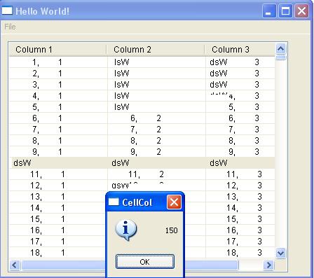

Hi my friends,
I´ve a little doubt. Please see the picture bellow. When did two clicks in grid sample, the message box show, and back stage, the content of the cell of the grid sample was changed... why it happen??
I had test on 2.9.5 and 3.0.0 in both cases i´ve the same "issue".
I´m using Windows XP SP/2, with default theme.
this image bellow,is the sample GRID.06.
With best regards,
PS: Sorry my poor english
Re: HMG 3.0 (Test IV)
Vanguarda wrote:Hi my friends,
I'm not able to reproduce here...
Any other thing that helps?
Roberto.
Sorry, I've tested on Win7 only. I've confirm the bug in XP SP3.
This will be another funny to fix :)
Thanks for the report.
Roberto.
