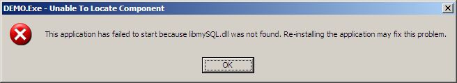

Now I can compile but it doesn't run :(
It shows a message:
But, I can't find MySql reference within my prg file:
Demo.zip
(3.48 KiB) Downloaded 395 times

Re: POSTGREQL Problem
Libmysql.dll? Interesting. :)
For me it says (null).dll.
I don't know what to do!
sudip
Posts: 1456
Location: Kolkata, WB, India
Post by sudip »
rathinagiri wrote:Libmysql.dll? Interesting. :)
Yes, because you have MySql installed in your computer :)
I got the same error message (null).dll when I copied LibMySql.dll into PGSql project folder for testing :lol:
There may be some errors within harbour pgsql library (if I am not wrong) :?
BTW, Apais once you told me about Postgresql (viewtopic.php?f=5&t=294&start=8). Have you used Postgresql with HMG?
IMHO, we shall wait for latest Harbour installation.
Master Roberto, please suggest :)
