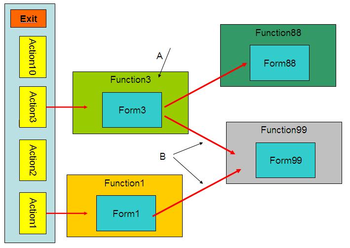

Hi guys,
I need your help.
I want develop a program with many form: ok, HMG can do it :D ! But I’m little confused :?: : I’ve read some topics but I don’t find (perhaps I don’t understand :oops: ) information about my problem.
I’ve difficult with English :roll: and for this reason, I’ve included a little image that shows the situation; I refer my questions to this image.
Prologue: all tables are open (and close) inside “Main” function; every function can do something with its form (call other function/form for example); sometime sub function/form can return value to the previous function/form.
Mine problems are:
A) If I close “Function3”/“Form3” when “Function88” /“Form88” are running, the program crash
B) If two functions call the same “Function99”/“Form99”, the program crash (because “Form99” it’s already defined; if I use IsDefined no very good).
This is a normal situation (I think) with a “complex” program (I think about ERP, etc. :mrgreen: ); I’ve tried combinations: std-form, child-form but without a solution :x . The only way is with modal-form, but I can’t execute “Function1” and “Function…” at the same time. Yes, I can do: “Action3”--->“Function3/Form3” --->”Function88/Form88” and then rollback.
It’s only a mine problem? There is a solution?

l3whmg wrote: Prologue: all tables are open (and close) inside “Main” function; every function can do something with its form (call other function/form for example); sometime sub function/form can return value to the previous function/form.
I'm not absolutely sure about to understand your problem, but I guess that I have a solution :)
There is two ways to work with forms in HMG:
1. Mimics 'SAY...GET...READ' Clipper behavior. You define thw window and its controls, then ACTIVATE WINDOW command creates a 'wait state' until the window is closed (as READ does in Clipper).
2. Mimics VB style. You define all your windows at application start and activate all of them in that moment, creating only one 'wait state' for the whole application. Then you show or hide windows as you need. In this scheme you will not code any define window or activate window commands in your functions (Only show and hide methods).
Look at \hmg\samples\noautorelease.
Please note that when you use 'NoAutoRelease' style clicking [X] do will not release the window from memory, it is only 'hidden'.
Roberto.

Prima di tutto, io ritengo che sia un problema di logica dei miei programmi e non di MiniGui; infatti, esso assolve bene il suo compito. La dimostrazione è data proprio dall’uso dei formati video “modal”: quando chiudo la finestra (e nel mio caso coincide con la funzione), i problemi non derivano da MiniGui, perché una ad una (in sequenza) le funzioni/finestre vengono chiuse.
Infatti, entrambe vi riferite alla logica di programmazione: “from modal approach (for dos and or console application and or command window applications) to event driven (windows)”.
Quindi, è meglio che io impari (oppure che io studi) una logica differente per i miei programmi.
Ad ogni modo, io includo un esempio di quello che io intendevo. nota bene: le funzioni/variabili che iniziano con "l3w" sono di utilità nei miei programmi per recuperare dei valori o impostare l'ambiente; non influisco sul problema descritto.
Seguirò il suggerimento di Roberto, ma se c'è qualcuno che ha ulteriori esempi...
A presto, grazie ancora!
