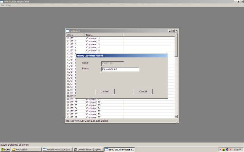

Hi Friends,
I just created my first SQLite project with facility to create databse, table and add, modify and delete records from a grid.
I added hbsqlit3 in Tools->Preferences->Additional Libraries textbox of IDE and made some changes in my old MySql project.
SQLite database app is ready!!!
Please download the source code
SQLite.zip
(9.05 KiB) Downloaded 2527 times
, compile and test.
Warning! Source code contains many quick and dirty codes, as I want to share my first excitement with you all. :)
I used some codes with (major) modification taken from samples of Harbour Installation's Contrib folder and Minigui Extended Samples.

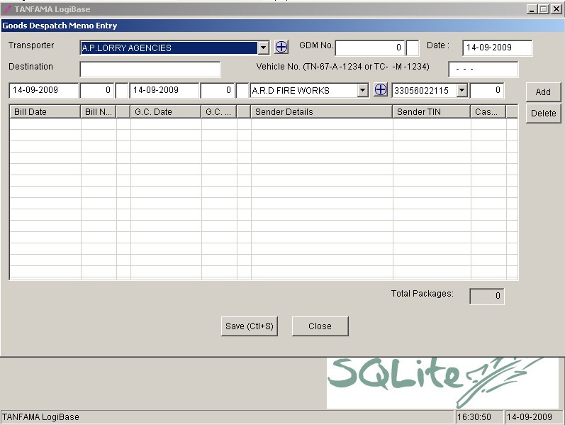

I had used this code to create a nice project called LogiBase for logistics management. My client didn't want to install MySQL and wanted the database to be a single file. It is single user. Hence I had used SQLite and even now they are using the same.
This is the logo of the program. :)
This is a screenshot.
