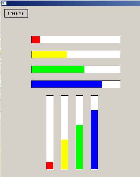

Here is a small utility to have customized progress bars. :)
Here is the screenshot.
Compile and use it.
progress.zip
(729 Bytes) Downloaded 450 times
Syntax is:
custom_progress_bar(cWindowName,nFromRow,nFromCol,nWidth,nHeight,aFillColor,nValue,nMax)
