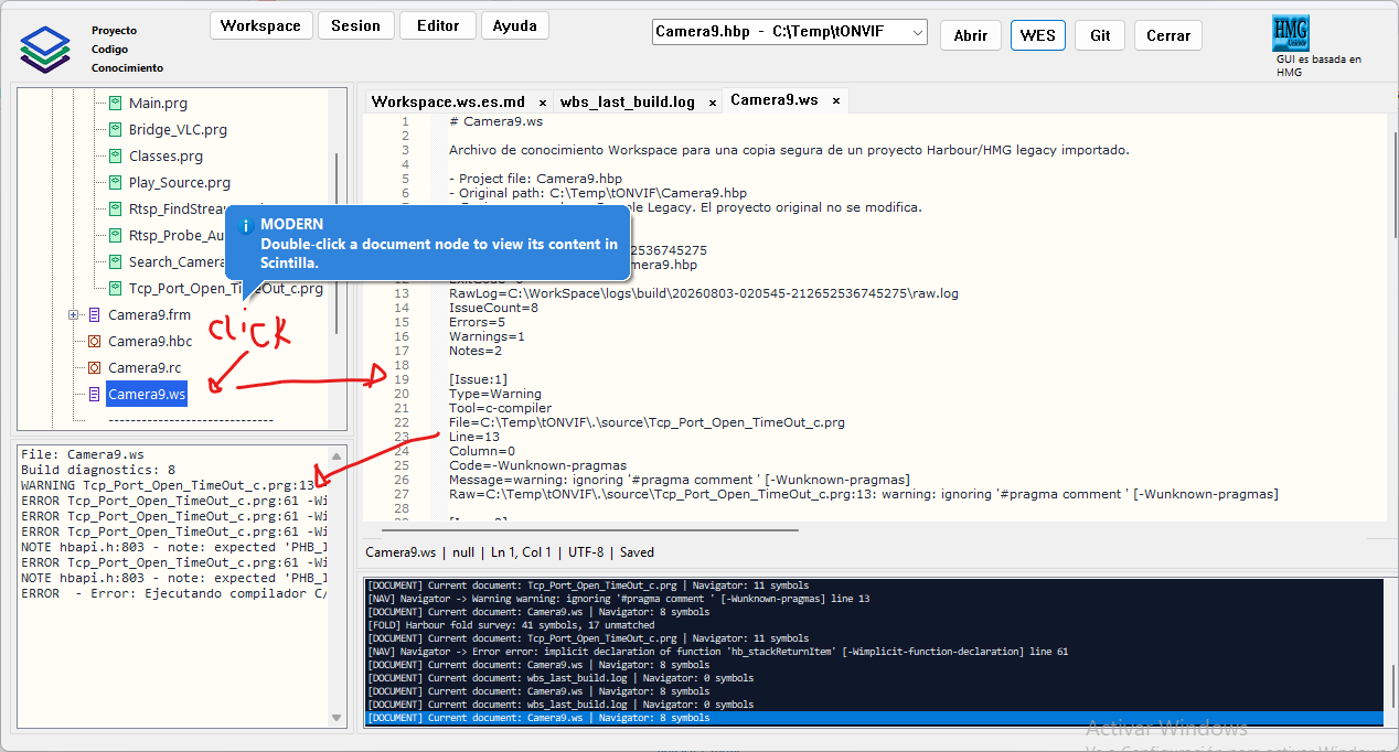

Hi everyone:
Today, after a very long time, Workspace is moving from being a sample to a trial version, removing elements that served merely as a bridge.
I have already added the services for Workspace; there are several of them, and they are described in the documentation.
Context:
Those services are interconnected and need to be tested in a real-world scenario; in my case, I was working on a PC application project for the HopeWay IP camera. It doesn't expose the camera via ONVIF—a feature found in many IP cameras—and since I was never able to resolve the errors, I put the project on hold.
...so the need for real projects with compilation errors came at just the right time for me.

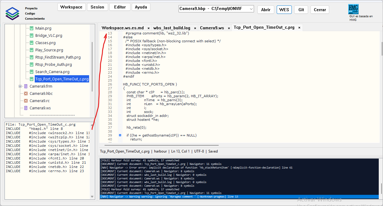

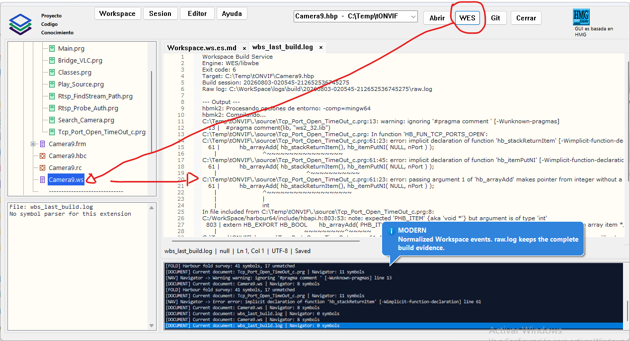

I already have the compilation service... it's called WBS; it runs from the command line or is launched via Windows Explorer, and it replaces HMG's Build.bat.
WBS (Workspace Build System) uses a library called WES (Workspace Engine System), which is responsible for assembling the entire project for hbmk2.
When HBMK2 executes that build, it calls Harbour, then the G++ compiler, and finally the linker.
All of this generates trace logs.
Ultimately, if the compilation is successful, it generates a simple log file named `build.log`.
But if there was an error, the IDE sometimes wouldn't give us the summary. That’s why I now have a compilation diagnostic service that generates a human-readable log—a more detailed and precise diagnostic.
This document is saved in the xx.ws file, which is readable by Scintilla; however, the Navigator does not provide precise details regarding the location of the error. You simply need to select the warning, error, or info item with the mouse, and it takes you to the document where the issue occurs.
I still need to make a few adjustments to the Workspace setup—similar to what I was doing before—so you can test it in your projects, identify any errors, and get them fixed.
I think being able to test it would really help me finish it up. Just a reminder that I work on this in my spare time; programming isn't my full-time job anymore—I moved on from that after doing it for years and years. My work now is as a piercer—something that used to be a hobby—much like being a lathe operator (which remains an unfinished project of mine because I lack the tools to build a small lathe just for fun).

PD: las imagenes de Workspace compilando con WES me permitio encontrar errores que IDE no me decia. ese ejemplo generaba .exe (clase tONVIF para camera9.hbp)
hoy WES con el codigo corregido pudo generarme el .exe

PS: The Workspace images compiling with WES allowed me to find errors that the IDE didn't tell me about. That example was generating an .exe (tONVIF class for camera9.hbp). Today, WES, with the corrected code, was able to generate the .exe.

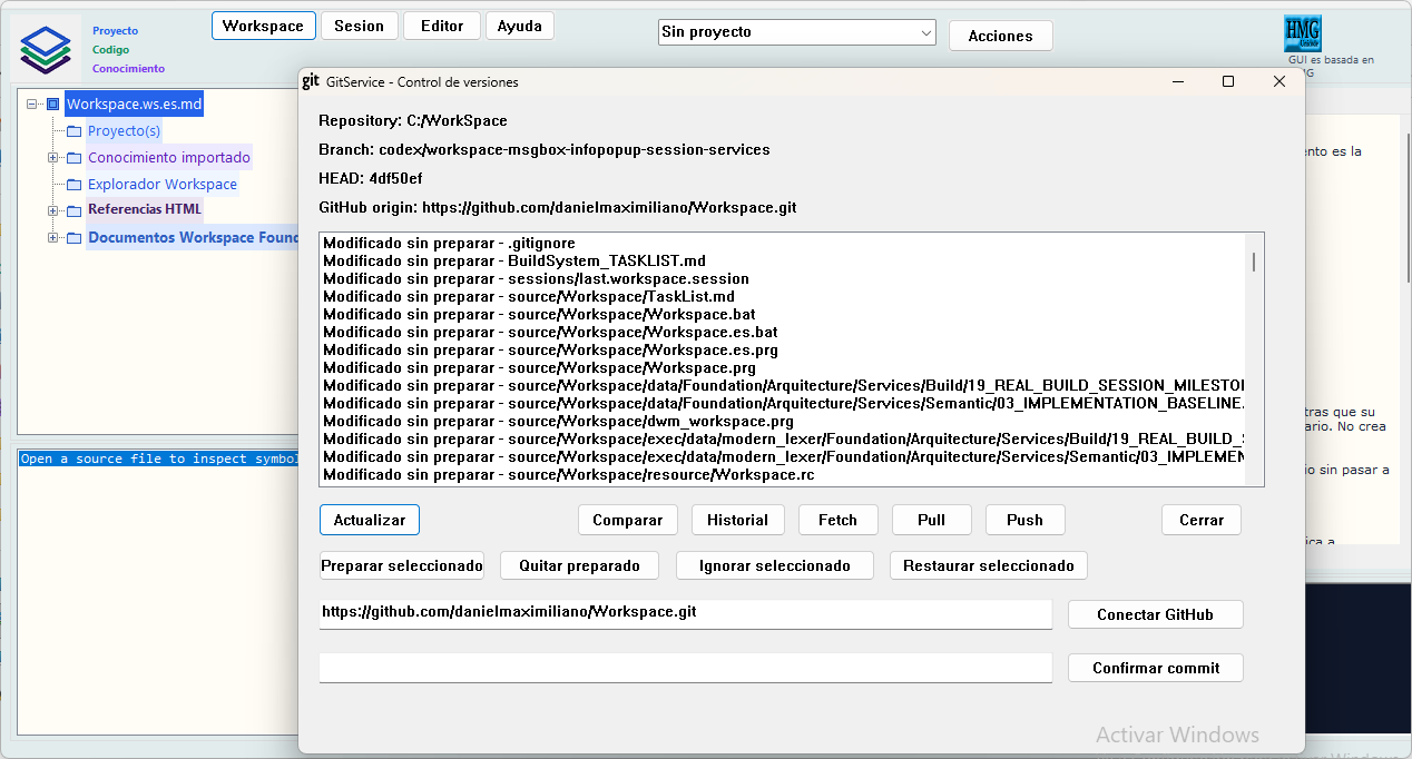

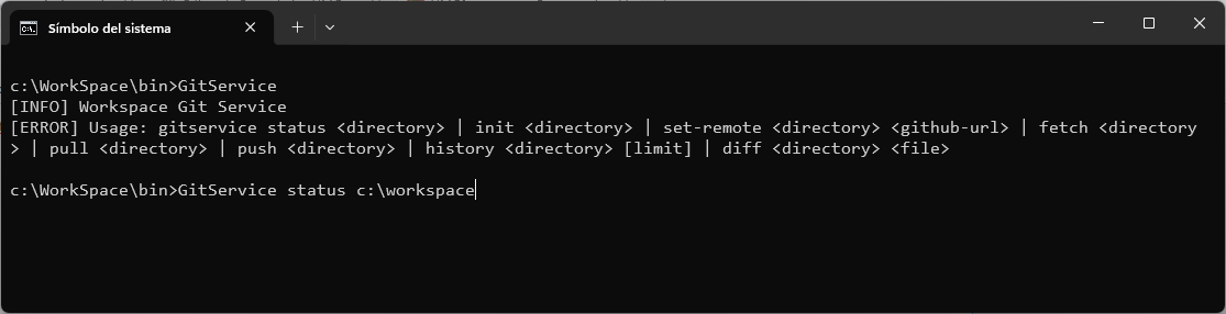

Hola a todos: el entorno de desarrollo Workspace ya tiene implementado en forma local y remoto GitService, un servicio dentro de Workspace y en host consola (CMD) , si quiere respaldar su codigo fuente dentro de GITHUB o en forma local .
forma de uso en CMD
los invito a probarlo, desde mi grupo en telegram estaré subiendo la nueva version que incluye esta y otras caracteristicas implementada estos dias.
enlace de Invitacion : https://t.me/HMGWorkspace
forma de uso en CMD

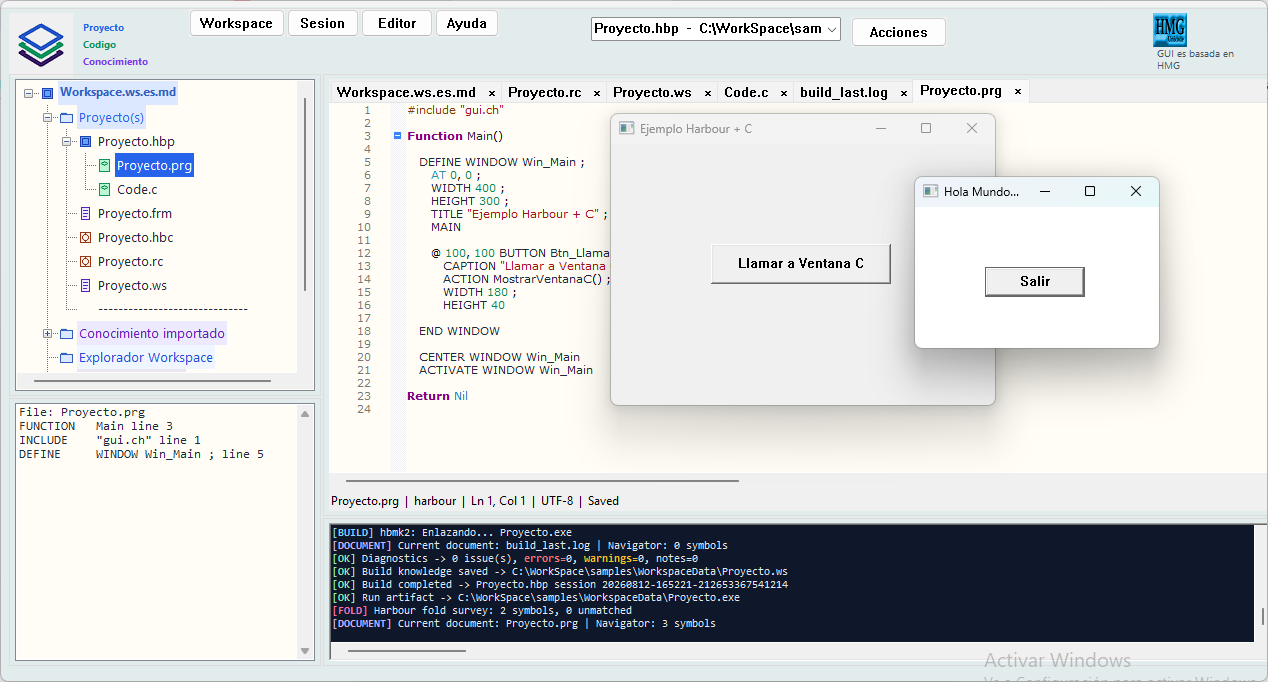

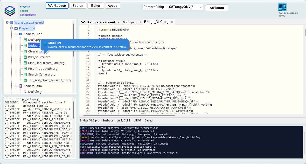

Hola a Todos : nueva implementacion en Workspace, la posibilidad de navegar en funciones C dentro de un .prg
Navigator reconoce funciones y punteros encerrados dentro de #pragma BEGINDUMP / #pragma ENDDUMP
asi como el proyecto puede contener archivos .c y .cpp
gcc:
Compila y enlaza C. Si le pasás .c, trabaja como C. Puede compilar .cpp si se lo forzás, pero al enlazar no siempre arrastra automáticamente la librería estándar C++.
g++:
Compila y enlaza C++. También puede compilar .c, pero puede tratar el flujo como C++ según opciones/extensión. Al enlazar, agrega automáticamente el runtime C++: libstdc++, soporte de excepciones, constructores globales, etc.
hoy Workspace trabaja con :
La diferencia práctica es esta:Proyecto
app.hbp
source\main.prg
source\window.prg
source\native_winapi.c
source\editor_bridge.cpp
gcc:
g++:
Harbour 3.2.1dev (r2607071005)
gcc (x86_64-posix-seh-rev1, Built by MinGW-Builds project) 16.1.0
g++ (x86_64-posix-seh-rev1, Built by MinGW-Builds project) 16.1.0
Re: Workspace - development environment
este proyecto : Proyecto.hbp contiene Code.c
- Captura de pantalla 2026-08-12 170613.png (107.78 KiB) Viewed 348 times
