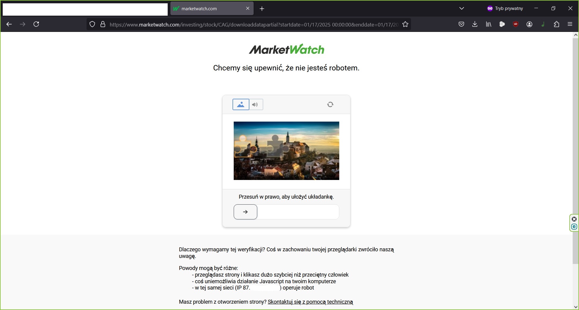

Unfortunately, but the marketwatch.com website has a bot protection.
If the website detects that you are downloading data in bulk and too fast, a captcha protection appears to confirm that you are a human. That is why you get garbage in response (html and js code trying to show a captcha image).

Ad.1 We cannot execute java scripts using the ServerXMLHTTP object. We would have to emulate the browser in some way, but I don't know how.
Ad.2 It seems to me that this would be sufficient if we wanted to download several dozen links, but not nearly 500 per day. In addition, it seems to me that web service checks the number of requests from the IP address, and this address does not change.
Ad.3 If the phyton code uses its own native libraries and/or classes, it may be difficult or impossible to convert it to harbour.
I'm sorry, but I can't help with this issue.
