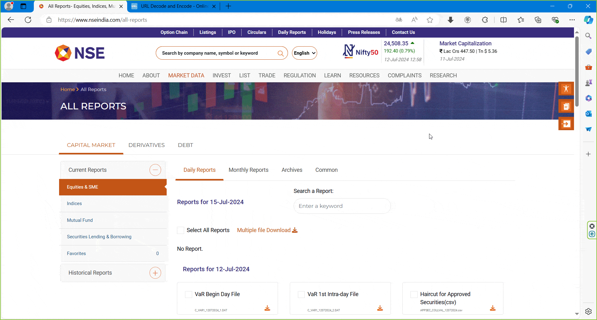

It's quite simple. To download a file, the browser must know its source/link. Once you have downloaded the file, select "Copy download link" from the list of downloads from the context menu. Such a copied link can be in URL encoded format, so it only needs to be decoded to the native one.
https://www.hmgforum.com/download/file.php?id=11971
A little tip: once you download a cookie, it has its own validity period, which is quite long. So you only need to download cookies once and authorize yourself with them when downloading subsequent archived data.
