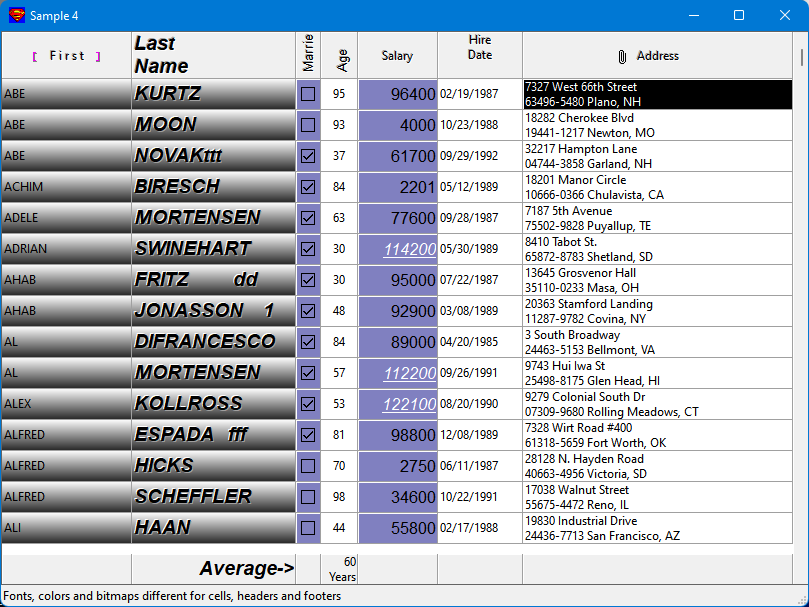

Hola,
I assume you mean the multi-line cell feature.
This is possible using the TBROWSE control in MiniGUI as shown in the image below.
- The Address column contains multiline strings.
- sample4.png (95.04 KiB) Viewed 4312 times

Hello, gfilatov. Yes, I want it to make rubrics. I built something like this:
