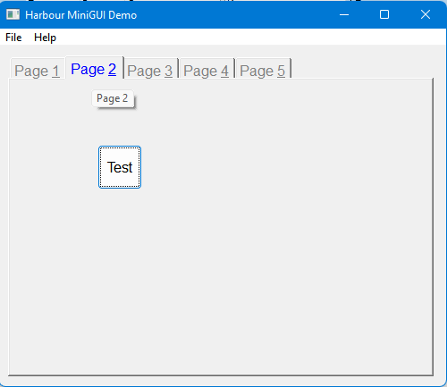

Como se puede hacer para que el FONT sea Arial Bold??
Y tambien se pueda hacer mas grande el FONT en el TOOLTIP??
Alguien sabe??
Gracias
How can I make the FONT Arial Bold?
And can the FONT in the TOOLTIP be made larger?
Someone knows??
Thank you

jorge_riv wrote: Thu Apr 18, 2024 4:10 am How can I make the FONT Arial Bold?
Someone knows??
Hello Jorge,
This is possible with the ownerdraw TAB control in the MiniGUI Ex (look at the picture below). :arrow:
Hope that is helpful. :idea:

I work with: Harbor MiniGUI Extended Edition 24.03 (Release), I found the example in the BASIC\TAB folder, but how can I enlarge the letters of the Tooltip???
