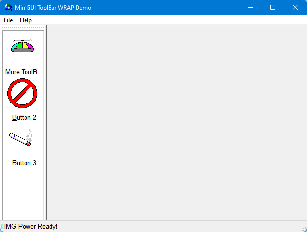

gfilatov
Posts: 1116
Location: Ukraine
Re: ToolBar position in a form
Post by gfilatov »
mol wrote: Sat Mar 09, 2024 3:32 pm I agree that the best place of toolbar is at the top. But, my form has two functions: one to add cheque and second - list of clients with texboxes of its properties and possibilities to edit and add new one.
It's my client request.
Hi Marek,
How about using a vertical toolbar as shown in the image below :?:
