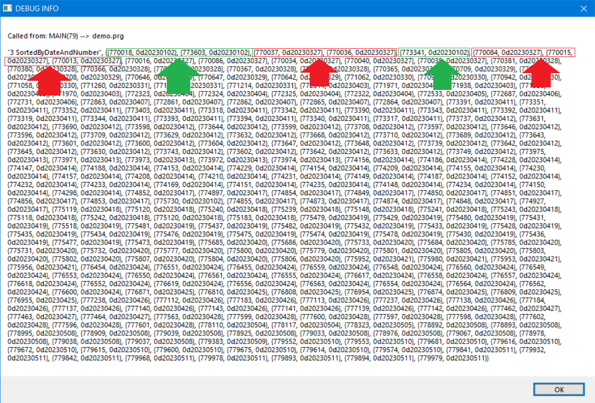

Friends, I have two questions/problems regarding arrays and sorting them.
I have a multidimensional array where the first element is a number and the second element is a date. My task is to sort the array by date and within the same date to sort by number.
Below is the code I use.

Local aSortedByNumber, aSortedByDate, aSortedByDateAndNumber
aSortedByNumber := ASort( aArray, , , { | x, y | x [ 1 ] < y [ 1 ] } )
msgdebug ( '1 SortedByNumber', aSortedByNumber )
aSortedByDate := ASort( aArray, , , { | x, y | x [ 2 ] < y [ 2 ] } )
msgdebug ( '2 SortedByDate', aSortedByDate )
aSortedByDateAndNumber := ASort( aArray, , , { | x, y | x [ 2 ] < y [ 2 ] .And. x [ 1 ] < y [ 1 ] } )
msgdebug ( '3 SortedByDateAndNumber', aSortedByDateAndNumber )
On my PC everything works as expected, but on some computers the same code, the same executable returns strange results. The resulting array is not sorted by date or number.
I don't understand it at all, and I don't know what the problem is, I thought it might be a hardware problem, e.g. it is different on AMD and Intel (I had a similar case with rounding floating-point numbers in the times of clipper), but it behaves differently on the same processor family.
The second question is how to store a sorted array in a variable to be able to use it later in the code?

I found a solution to my first problem: I converted the array data to a string and sort by string.
aSortedByDateAndNumber := ASort( aArray, , , { | x, y | hb_TtoS( x [ 2 ] ) + StrZero ( x [ 1 ], 10 ) < hb_TtoS( y [ 2 ] ) + StrZero ( y [ 1 ], 10 ) } )
Now works on all computers. I wonder why the native solution doesn't work?
