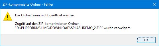

Re: Photos
can not open ZIP Files as Windows Defender give a Error Message about "Trojan_WACATAC.B!ML"
