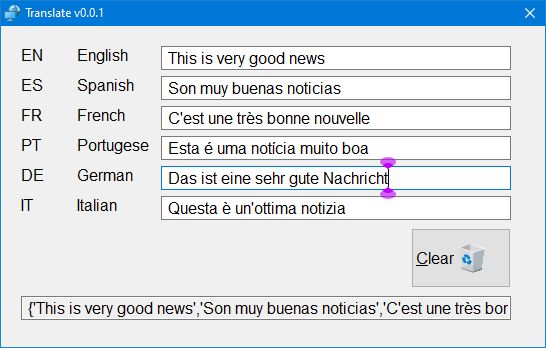

App to create Multi Language Array
under Fivewin there i a Function FWString(cSeek)
FWString() use Array for {"EN", "ES", "FR", "PT", "DE", "IT"} Language
but i ´don´t know other than DE or EN so i have to use Google Translate
Layout have 6 x TEXTBOX and "react" ONENTER to connect to Google
after got Translation for all "other" Language i create a String for Array
LOCAL aTRANSLATE := {}
AADD(aTRANSLATE,{'Next try','Próximo intento','Prochain essai','Próxima tentativa','nächster Versuch','Prossimo tentativo'})
AADD(aTRANSLATE,{'yes that's how it works','si asi es como funciona','oui c'est comme ça que ça marche','sim é assim que funciona','ja so geht es','si è così che funziona'})
AADD(aTRANSLATE,{'and now','y ahora','et maintenant','e agora','und nun','e adesso'})
AADD(aTRANSLATE,{'further','más','plus loin','avançar','weiter','ulteriore'})
AADD(aTRANSLATE,{'return','devolver','retour','retornar','zurück','ritorno'})
AADD(aTRANSLATE,{'forward','adelante','avant','avançar','vorwärtz','inoltrare'})
AADD(aTRANSLATE,{'go to','ir a','aller à','Vá para','gehe zu','vai a'})
AADD(aTRANSLATE,{'7 in one fell swoop','7 de un solo golpe','7 d'un coup','7 de uma só vez','7 auf einen Streich','7 in un colpo solo'})
AADD(aTRANSLATE,{'7 Dwarfs','7 enanos','7 nains','7 anões','7 Zwerge','7 Nani'})
AADD(aTRANSLATE,{'Xbase++ after FiveWin','Xbase++ después de FiveWin','Xbase++ après FiveWin','Xbase++ após FiveWin','Xbase++ nach FiveWin','Xbase++ dopo FiveWin'})
but don´t know if those Translation are "good" to understand
also Ampersand, & for Hotkey. also are missing ... "where" to set in "other" Language ...
so when we want to use this Technique for HMG i ask for Help when Language is not DE or EN
i can do the Job for DE when have EN Translation
Comment welcome

here Source CODE and working App
GOOGLE7_001.zip
(1.55 MiB) Downloaded 334 times
! Note : as always i do NOT provide any Image
there is a *.RC in \RES\GOOGLE7.rc as Sample

Jimmy,
Some translations are missing: try this 'Das ist eine sehr gute Nachricht' and my French gives: 'C'est une trŠs bonne nouvelle'
Some adjustment missing?
Re: App to create Multi Language Array
hi Serge,
i can not confirm it, it look right in my Sample
did you compile using Unicode :?:
can Notepad show UTF-8 :?:
at End of App i have
  _Execute( 0,, "Notepad","_LOGIT2.TXT",, 5 )
the File "_LOGIT2.TXT" is UTF-8 which i can "check" with NPP
AUGE_OHR wrote: Wed Apr 05, 2023 7:54 pm hi,
In Win11...
Notepad utf-8.png (11.42 KiB) Viewed 17315 times
Jimmy,
This is from my _LOGIT2.TXT: AADD(aTRANSLATE,{'This is very good news','Son muy buenas noticias','C'est une trŠs bonne nouvelle','....
S
hi Serge,
what is in your Config.INI
i have enable REQUEST HB_CODEPAGE_*** only for "EN","ES", "FR", "PT", "DE", "IT"
it "might" be that it "display" wrong but IHMO Answer from Google should be OK
Answer from Google are Unicode but (older) Notepad are just ANSI ... sorry my Error
please try Notepad++ if _LOGIT2.TXT "display" right using UTF-8
Hi Jimmy,
config.ini:
Keyboard=1033
Language=EN
Codepage=EN
+ Italian, Spanish and Portugese (and Svenska) are also corrupted.
I added 2 languages: SV svenska and NL Nederlands (Dutch). The dutch and english are OK due to no accents in most cases.
What has Notepad to do with Google answer?
