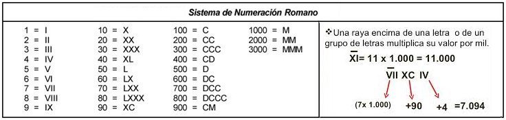

Hola Serge:
Creo que A partir de -> 3999 la Letra o grupos de Letras llevarán encima -> ¯
https://www.hmgforum.com/viewtopic.php? ... man#p41597
Hello Serge:
I think that from -> 3999 the Letter or groups of Letters will carry -> ¯
Greetings
