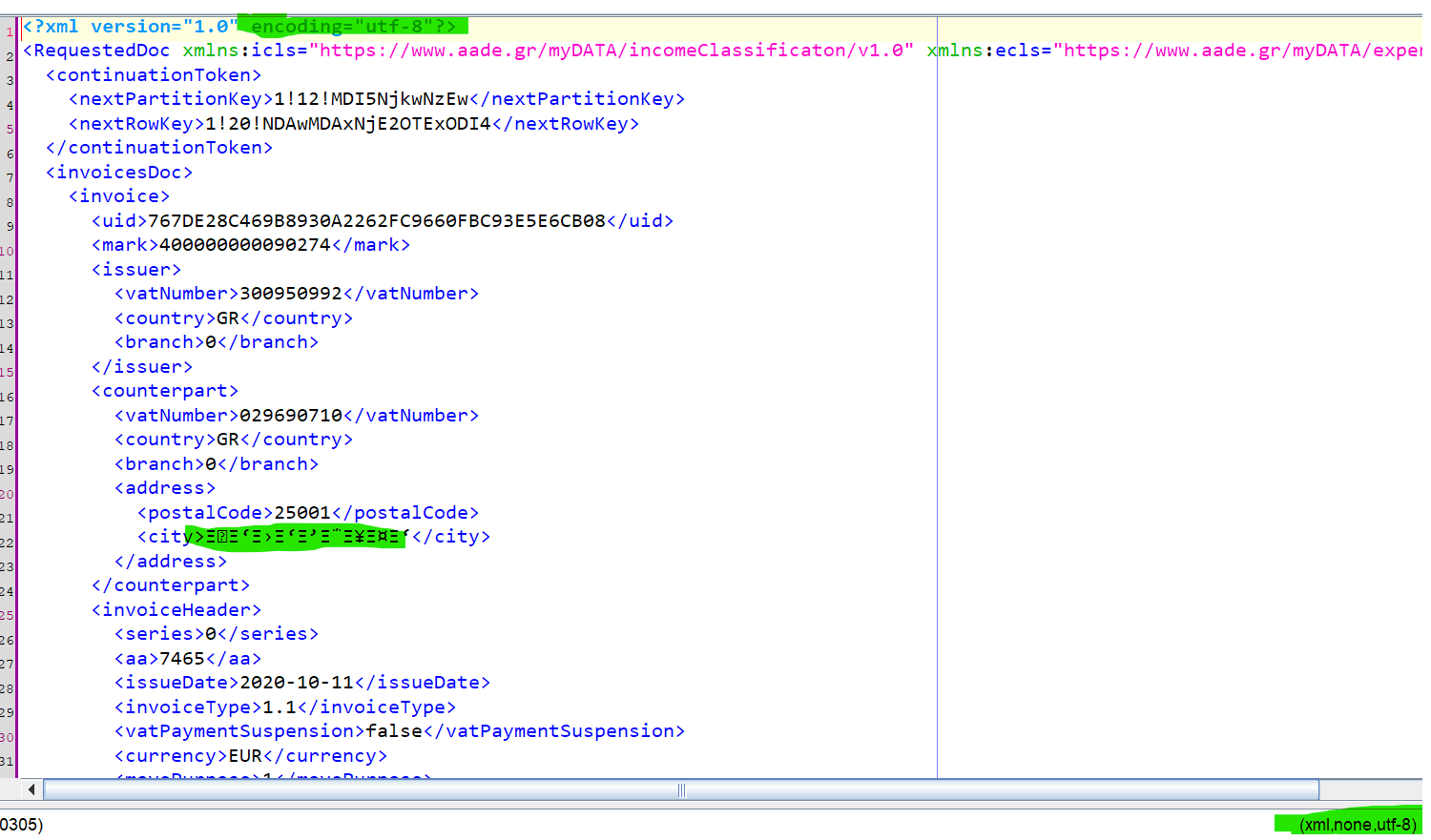

Your sample xml file contains 999 invoices, but I "don't like" the Greek city and street names written in it. The xml file is declared as UTF-8, but Greek letters appear strangely for me.
greek utf8.png (82.88 KiB) Viewed 7927 times
