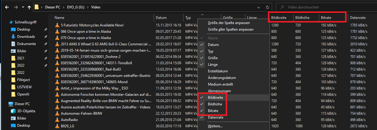

"more" Grid Header
"more" Grid Header
when using DIRECTORY() we have up to 10 Column (directry.ch) which can be filled by OS Data
but Windows Explorer can show "more" Column when right-click on Header
so how can i get "these" Column into my Grid :?:
need "Keyword" to search or "ask" ChatGPT

Hi Jimmy,
Is this what you mean?

Re: "more" Grid Header
hi
Serge,
YES, it seem to be what i´m looking for
Question :
"where" do you got "Name" in your Array :?:
   aMusic_Headers
   aPhoto_Headers
it seems "Name" must match Language to get Result ( else empty)
Hi Jimmy,
"Name" is just a translation for the headers. You can fill it in how you wish.
hi Serge
serge_girard wrote: Mon Dec 19, 2022 5:42 pm "Name" is just a translation for the headers. You can fill it in how you wish.
aha :idea:
understand thx
