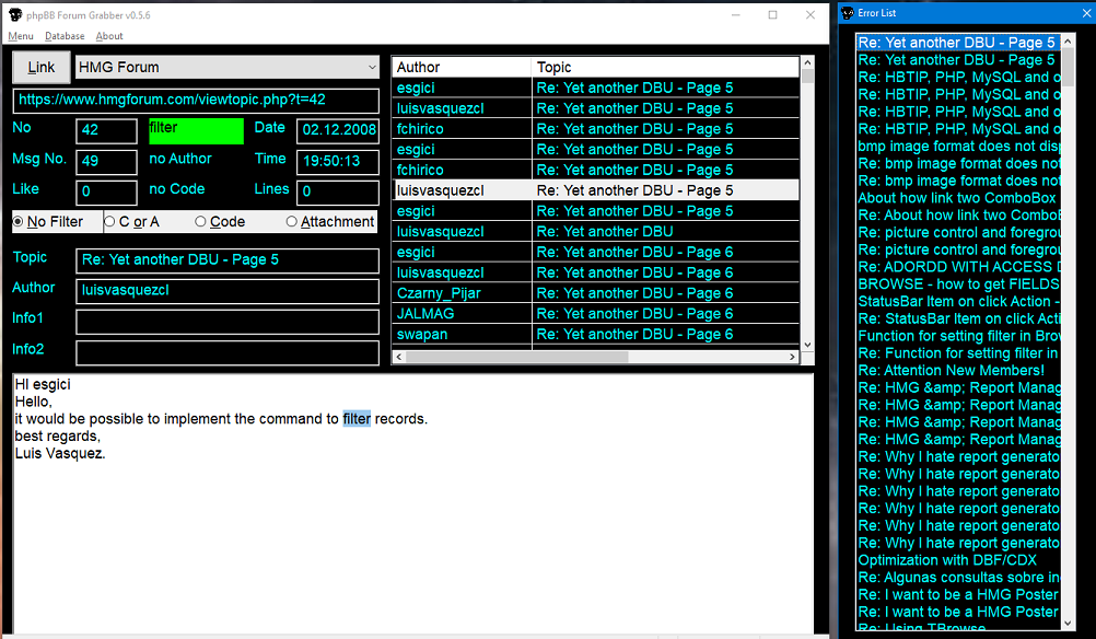

thx all for Answer.
i have test temporary Index and "other" Concept when "search" in Forum Message.
FILTER or Index is like Online where you "just" get "Result"
but often you need hole Thread which include the Message to understand "hole Story"
i do have, on right side, Window for "Thread-Error" when download and also use for Attachment
now i use same Style for "FILTER" and present "Result" on right side
when navigate on right side it will "sync" Main so i can read Message.
i use Index TAG "DUOECHECK" which does sort Thread-No so i can "see" hole Thread
here last Version of Modul SETFILTER.PRG
you need to delete all SET FILTER in ChangeFilter() except for Radio-Button
SETFILTER_056.ZIP
(2.83 KiB) Downloaded 225 times
