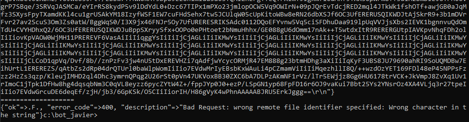

I'm having trouble with the sendPhoto function since as I understand it requires converting the png image file to base64, so I'm trying something like this:
local cImgLocalPath := "c:\bot_javier\image.png"
cImgFileContent := FileStr( cImgLocalPath )
cBase64ContentFile := hb_Base64Encode( cImgFileContent, Len( cImgFileContent ) )
oBot:sendPhoto( chat_id, "caption", cBase64ContentFile, "" )
but I get this error response:
do we have some function to convert the image file to base64?, I'm doing something wrong with?.
I appreciate any help.
Javier

Did you check exact error? Wrong remote file identifier specified: Wrong character in the string.
Maybe see: https://github.com/telegraf/telegraf/issues/886

When browsing the sources of the hbtelegram class https://github.com/riztan/hbtelegram/bl ... _class.prg, it seems that we do not encode the image file bytes, but only provide the full path to the file that we upload to the server.
METHOD sendPhoto (uChatId, cCaption, cImagePath, oMsg, hOptionals)
Okey. I've looked at this class in more detail, and it doesn't allow file uploads using multipart/form-data required for file upload from computer.
https://core.telegram.org/bots/api#sendphoto
You have to build the request yourself, it should look something like this:
cChat_id := oMsg:chat:id   /* Chat ID */
cCaption := "Any caption"
cPhotoFile := "c:\bot_javier\image.png"
boundary:='------' + hb_StrToHex ( hb_TtoC( hb_DateTime(), 'YYYYMMDDhhmmssfff' ) )
cFormBody:='--' + boundary + CRLF
cFormBody+='Content-Disposition: form-data; name="chat_id"' + CRLF + CRLF
cFormBody+= cChat_id + CRLF
cFormBody+='Content-Disposition: form-data; name="caption"' + CRLF + CRLF
cFormBody+= cCaption + CRLF
cFormBody+='--' + boundary + CRLF
cFormBody+='Content-Disposition: form-data; name="photo"; filename="' + hb_FNameNameExt ( cPhotoFile ) + '"' + CRLF
SWITCH Upper(hb_FNameExt ( cPhotoFile ))
	CASE "JPG"
		cContentType:='image/jpeg'
		EXIT
	CASE "JPEG"
		EXIT
	CASE "BMP"
		cContentType:='image/bmp'
		EXIT
	CASE "PNG"
		cContentType:='image/png'
		EXIT
	OTHERWISE
END SWITCH
cFormBody += 'Content-Type: ' + cContentType + CRLF + CRLF
cFormBody += FILESTR( cPhotoFile ) + CRLF
cFormBody+='--' + boundary + '--' + CRLF
aHeaders := {  "Content-Length: " + Str(Len(cFormBody)) , ;
	       "Content-Type: " + "multipart/form-data; boundary=" + boundary }
curl_global_init()
pCurl := curl_easy_init()
/* Specify the Header  data */
curl_easy_setopt( pCurl, HB_CURLOPT_HTTPHEADER, aHeaders)
curl_easy_setopt( pCurl, HB_CURLOPT_URL, oBot:cUrl + "sendPhoto" )
curl_easy_setopt( pCurl, HB_CURLOPT_FOLLOWLOCATION, .T. )
curl_easy_setopt( pCurl, HB_CURLOPT_SSL_VERIFYPEER, .F. )
curl_easy_setopt( pCurl, HB_CURLOPT_DOWNLOAD )
curl_easy_setopt( pCurl, HB_CURLOPT_DL_BUFF_SETUP )
curl_easy_setopt( pCurl, HB_CURLOPT_POST, .T. )
curl_easy_setopt( pCurl, HB_CURLOPT_POSTFIELDSIZE, LEN( cFormBody ) )
curl_easy_setopt( pCurl, HB_CURLOPT_POSTFIELDS, cFormBody )
nResp := curl_easy_perform( pCurl )		/* Do everything */
/* Look at execute method class TLGRMBOT todo get response or catch errors */
I haven't tested so it's just a tip, I'm not using this class and I'm not going to be yet.
PS.
This class seems underdeveloped. See for example the :sendVoiceFile method. It uses the external curl command instead of the native libcurl commands.
