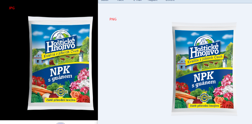

Hello everyone.
I need help with a function from Bos Taurus.
If I open a PNG file
hBitmap := BT_BitmapLoadFile (cLocalTempFile) and have it saved as a JPG
BT_BitmapSaveFile (hBitmap, cLocalTempFile, BT_FILEFORMAT_JPG)
it changes my background color to black.
It is possible to set or change it somewhere
Georg_BA

I am attaching the files for the test

Hi Georg,
The background turns to black because the png file contains a transparency layer which you cannot transfer to the .jpg format. Try this sample code if you please:
Local hBitmap := NIL
Local hBitmap2 := NIL
hBitmap := BT_BitmapLoadFile("62451.png")
hbitmap2 := BT_BitmapCreateNew (BT_BitmapWidth (hBitmap), BT_BitmapHeight (hBitmap), {255,255,255})
BT_BitmapPasteTransparent (hBitmap2, 0, 0, , , BT_COPY, hBitmap, )
BT_BitmapSaveFile (hBitmap2, "new.jpg", BT_FILEFORMAT_JPG)
I hope it helps!

Thanks for the help, but the result is the same

Georg_BA wrote: Thu Sep 29, 2022 11:20 am Thanks for the help, but the result is the same
Hi Georg,
The suggested code for conversion your PNG file is correct.
Please take a look at the attached JPG result file with white background after conversion. :arrow:

Vagelis & Grigory
Thanks for help
I went through it again, and the fault was between the chair and the computer. :oops:
Everything works correctly there is a white background
Sincerely Georg
