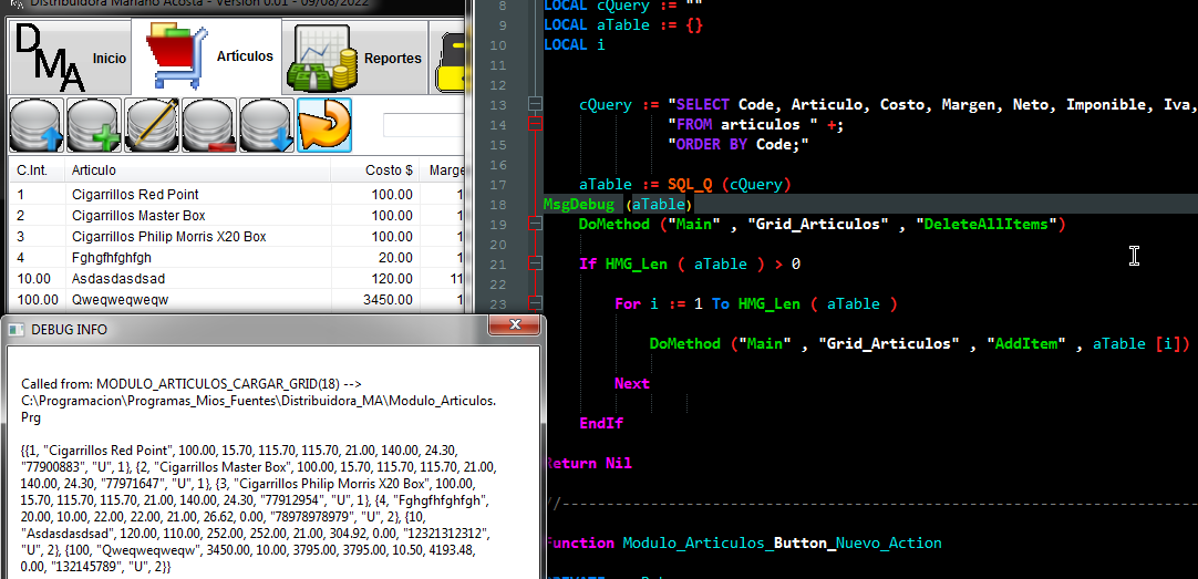

Hello Friends !!! Sorry for the absence... today it brings me a problem with a grid control !
And I turn for help to the wise men of the forum who have always helped me so much !!!
The first column comes from a MariaDB "Int" field... and grid add decimals only in the first col when len > 1 :o
It had never happened to me... If any have a solution I'll be very greatful !!!
Screenshot of Heidi SQL table "articulos":
And grid definition code:

Gracias Martin por tu rápida respuesta pero este grid no es editable ni lleva controles es sólo para mostrar los artículos.
En el array se vé que es numérico ese item y su valor correcto pero el grid le agrega decimales no sé porqué...
Thank you Martin for your quick response but this grid is not editable nor does it have controls, it is only to display the articles.
In the array you can see that this item and its correct value are numeric, but the grid adds decimals to it, I don't know why...

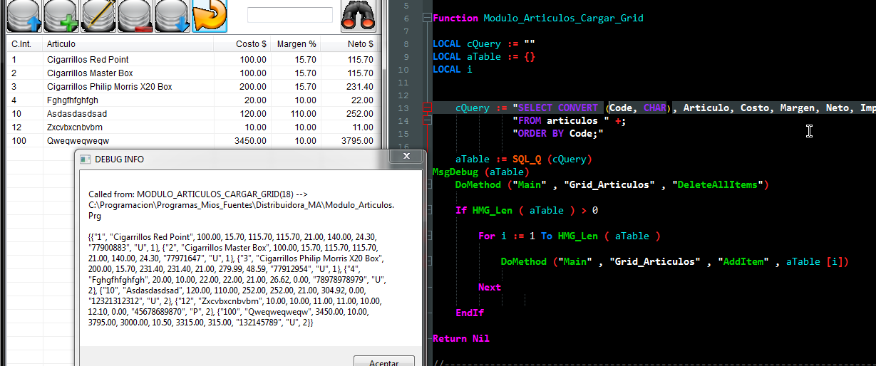

I don't use mysql this day but database is database, try
SELECT round(code,0), articulo, cost ...
or better
SELECT truncate(code,0), articulo, cost ...
Re: Grid issues
Anyway: convert to string!

I knew that the first column cannot be justified to the right but I did not know that I would have
problems if I want to load it with a numerical data...
Rathinagiri: I did that to fix it, convert the value to character, see screenshot below.
Jorge: In the second screenshot you can see part of the table opened with Heidi SQL,
the field in question is Integer and the array with which I load the grid shows it like this.
Dragancesu: It didn't work because in the array it already came in numerical format without decimals,
see first screenshot ( MsgDebug(aTable) ), but it gave me the idea of how to solve it.
Serge: Yes... the best idea... "SELECT CONVERT (Code, CHAR), Item, Cost, Margin, Etc. It Work... :P
Martin: I'm going to study your method more time... for now I found a solution...
