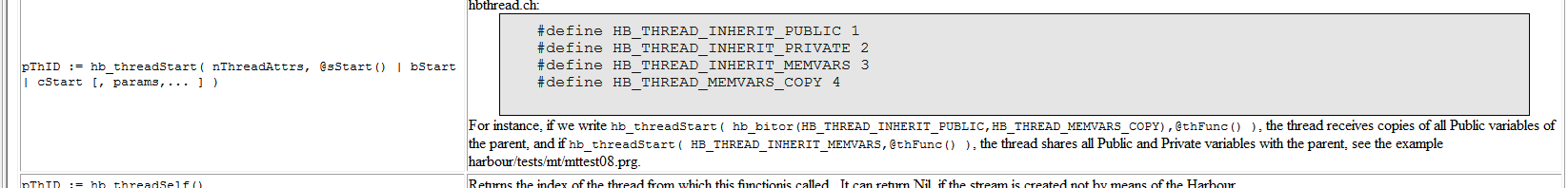

Now about the access to the databases in multi-threaded applications. working area (workareas) in the Harbour are local to the thread, i.e. each thread has its own independent workspaces and aliases, and, in the general case, if you need a database in the thread "B" which is already opened in the thread "A", you need to open it in the "B" agein, which is easy to do in shared mode.

If every thread has its own world, is the way to return some results from thread?
