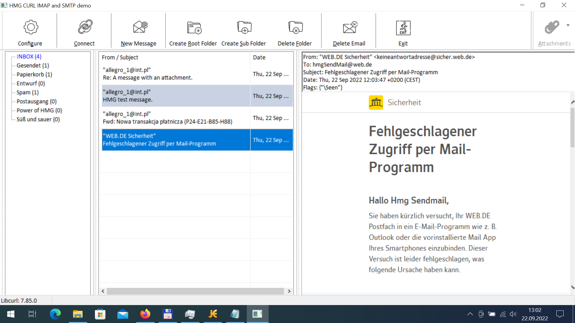

Support for IMAP and SMTP protocols from HMG using the latest fork of the libcurl library.
In the attachment I am sending sources, libraries for example of using libCurl in communication with mail servers via IMAP and SMTP protocols.
The program was tested on several IMAP servers: web.de; gmail.com; om.pl; onet.pl using both SSL and STARTTLS - however, I can not guarantee that it will work properly on all servers, I worked a bit in the dark, mostly by trial and error, because IMAP documents are quite extensive, I focused on the basic activities: logging, listing, reading messages, sending messages, deleting messages, creating and deleting folders, and placing messages after sending to the 'Sent' folder.
Attached is a ready configuration for connecting to the IMAP web.de server, but you can try to connect to your server by simply selecting the Configure button.
Important. The newest libraries for both libcurl and the Harbour fork of this library are required for the program to compile.
The libcurl.dll (version 7.85) and the rest of the .dll files should be placed in the same folder as the executing program. The libCurl fork for Harbour is located in the hmg.3.4.4 subfolder. You need to copy the contents of this folder to your location of hmg.3.4.4 (not tested on other versions) overwriting old files.
The new fork is necessary to be able to read the information headers sent from the IMAP server. Unfortunately, the native functions for reading these headers do not work in this fork, the solution is to process them in debug mode, which slows down the whole process, but well: Beggars can't be choosers ;-)
Note, use this tool with caution as folders and messages can be deleted.
IMAP folder names are encoded in mUTF-7 (modified UTF-7), so there is support for this encoding in the source.
I noticed that TipMail doesn't always work properly with all message formats, but I haven't found a newer version on the web, so we have to deal with its limitations. Also, ActiveX shell.explorer.2 support from a thread other than the main thread causes the program to crash, so I resigned from a separate thread for reading messages and download them in the main one.
PS. A big thank you to Marek (MOL) for the effort he put into paving the way for success.
Some comments and functions may be in Polish, which I'm sorry for, but I didn't have much time to clean up the code. I hope the code will be quite understandable after all.
edk.
imap_Curl.7z
(3.29 MiB) Downloaded 921 times
