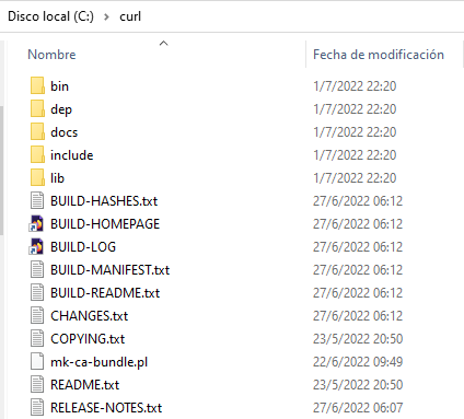

Hi Jimmy
TRY download Curl
example : https://curl.se/windows/dl-7.84.0_3/cur ... -mingw.zip
extract and copy to folder
2022-07-01 22_25_55-curl.png (13.27 KiB) Viewed 3761 times

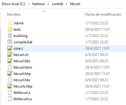

use this batch
set HB_WITH_CURL=C:\curl\include
set HB_STATIC_CURL=yes
set path= %path%;c:\hmg.3.5
build64  hbcurl.hbp
pause
in folder
2022-07-01 22_28_10-hbcurl.png (13.11 KiB) Viewed 3761 times
see content in build.log
