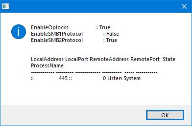

   Msginfo(cShow)

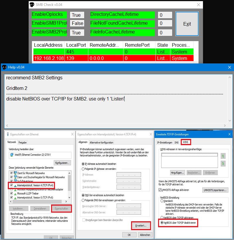

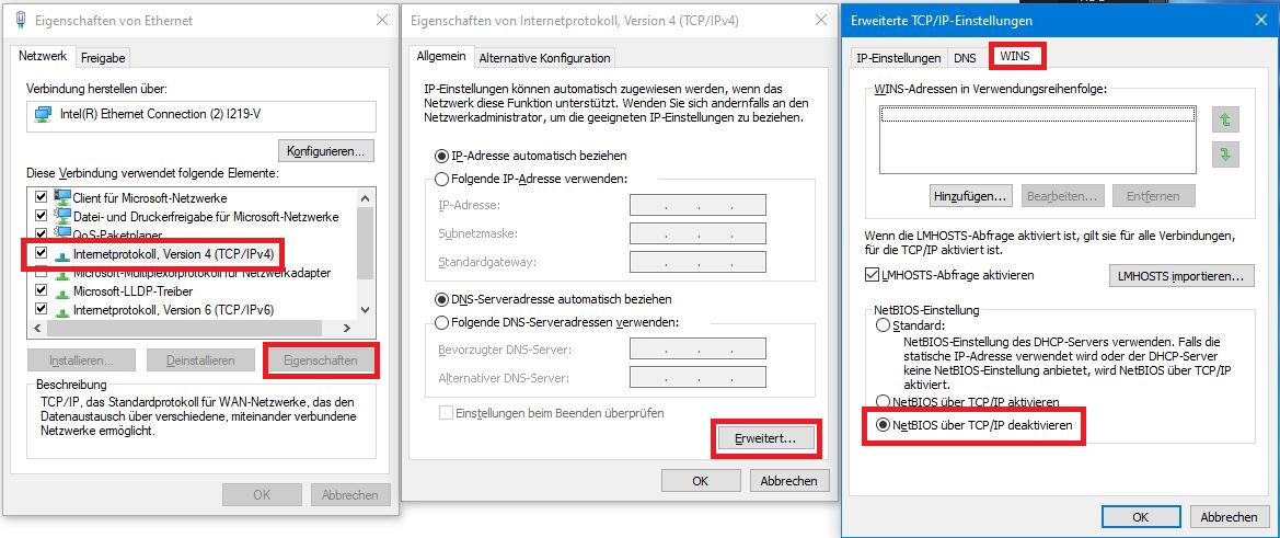

as i say it is not good when Windows "listen" to both Port
if Windows is "Listing" to UPD Port 139 disable "NetBIOS"
p,s don´t forget to disable SMB2 "Local Cache"

here full Source Code ( no Resource )
CHECKSMB.ZIP
(1.63 MiB) Downloaded 121 times
press "Start" to get Result
for more Information press F1
you can press Ctrl-R to re-check
