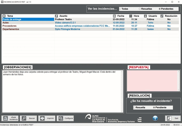

Something like this
The two fields call [OBSERVACIONES] and [RESPUESTA] are memo fields of the Data Base in the grid above them

Algernon wrote: Tue May 24, 2022 7:53 am Something like this

Yes, Design, I use two memo field in this Data Base and then I use ON CHANGE clause of the GRID to show the content of the memo field
