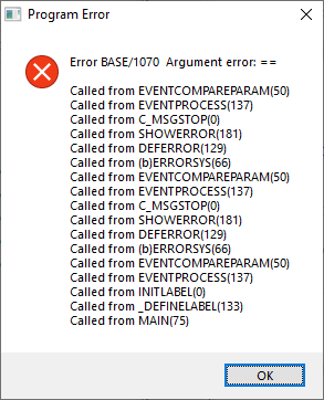

This code correctly determines which LABEL control has focus by using the mouse cursor’s position. Cool!
Although this code works great with LABEL controls it FAILS when a RADIOGROUP control is substituted. Sad!
Here are my three simple alteration to Serge’s code:
1) - I made the FORM a bit wider.
2) - I changed the array’s 2nd row's name to "RadioGrp2".
3) - In the FOR n := 1 TO Len(aLabel) loop I substituted a RADIOGROUP control in iteration #2.
With my iteration #2, if ( n == 2 ), included I get the error that I just cannot understand.

HELP, I'm out of ideas. Does anyone understand why a RADIOGROUP control fails?
OR Can someone give guidance on some way to determine GotFocus and LostFocus on a RADIOGROUP control.

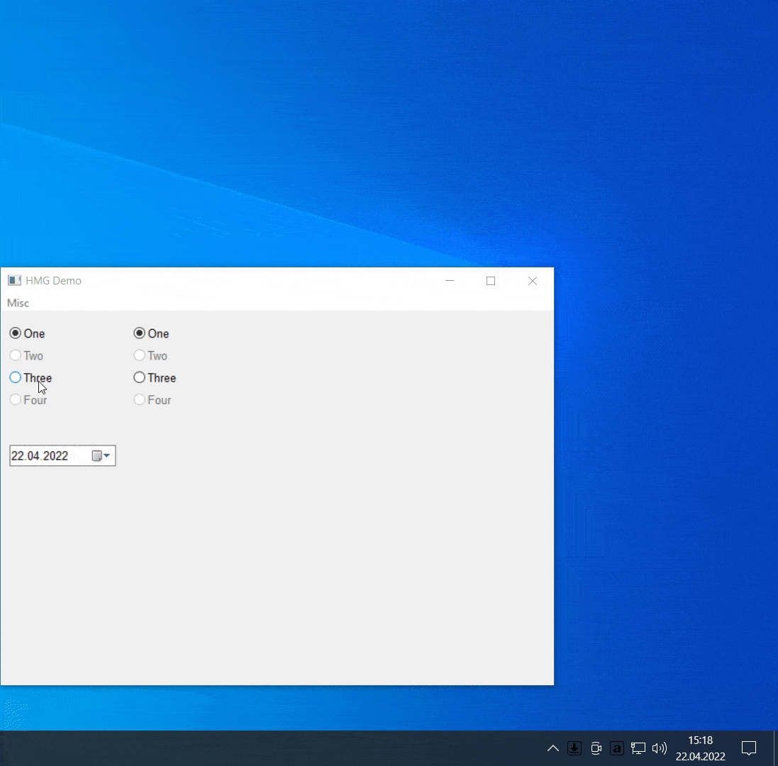

Workaround for Got Focus and Lost Focus missing events for RadioGroup (only works with getting / losing focus using the TAB key)
	DEFINE WINDOW Form_1 ;
		WIDTH 640 HEIGHT 480 ;
		TITLE 'HMG Demo' ;
		MAIN ;
		FONT 'Arial' SIZE 10
		DEFINE RADIOGROUP Radio_1
			OPTIONS	{ 'One' , 'Two' , 'Three', 'Four' }
			VALUE	1
			WIDTH	100
			TOOLTIP	'RadioGroup'
			ONCHANGE  MsgBalloon( "On Change", "RadioGroup 1" )
			READONLY { .F. , .T. , .F. , .T. }
			ROW	10
			COL	10
		END RADIOGROUP
		DEFINE RADIOGROUP Radio_2
			ROW 10
			COL 150
			VALUE 1
			WIDTH 100
			ONCHANGE MsgBalloon( "On Change", "RadioGroup 2" )
		END RADIOGROUP
		@ 150,10 DATEPICKER Date_1 ;
		VALUE CTOD('  / /  ') ;
		TOOLTIP 'DatePicker Control'
	Form_1.date_1.SetFocus
	Form_1.Center
	CREATE EVENT PROCNAME cProcRadioGroup()
	Form_1.Activate
Function cProcRadioGroup( )
Local nMsg   := EventMSG ()
Local hWnd   := EventHWND ()
Local wParam := EventWPARAM ()
Local lParam := EventLPARAM ()
DO CASE
	CASE ASCAN ( Form_1.Radio_1.Handle, hWnd ) <> 0		//Handles of Radio_1
		DO CASE
			CASE nMsg == WM_KEYUP .AND. LoWord ( wParam ) == VK_TAB
				MsgBalloon( "Got Focus", "RadioGroup 1" )
			CASE nMsg == WM_KEYDOWN .AND. LoWord ( wParam ) == VK_TAB
				MsgBalloon( "Lost Focus", "RadioGroup 1" )
		ENDCASE
	CASE ASCAN ( Form_1.Radio_2.Handle, hWnd ) <> 0		//Handles of Radio_2
		DO CASE
				MsgBalloon( "Got Focus", "RadioGroup 2" )
				MsgBalloon( "Lost Focus", "RadioGroup 2" )
		ENDCASE
ENDCASE
RETURN Nil
Procedure MsgBalloon( cMessage, cTitle )
	Default cMessage := "Message", cTitle := "Title"
	ShowNotifyInfo( GetActiveWindow(), .T. , Nil, Nil, cMessage, cTitle, .T., .F., .F. )
	Do Events
	ShowNotifyInfo( GetActiveWindow(), .F. , Nil, Nil, Nil     , Nil   , .F., .F., .F. )
RadioGroup Got and Lost Focus events.gif (687.29 KiB) Viewed 3206 times

Thank you so much EDK for your very generous guidance. I am one step closer!
First, let me explain my purpose. I want to clearly show the user which control has focus.
Using events OnGotFocus() an OnLostFocus() I alter BackColor and FontSize to show Focus.
For whatever reason HMG does not implement these Events for the RADIOGROUP control!
This is unfortunate.
Now when TABBING into a RADIOGROUP I can hook into "GotFocus" and "LostFocus".
EDK's post clearly states that this "only works with getting / losing focus using the TAB key)".
I'm nearly there but I still have one problem!
When clicking in or out of a RADIOGROUP these hooks simply CANNOT fire!
