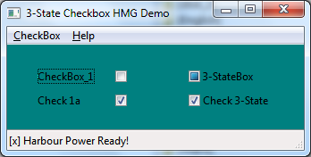

Please take a look for the screenshot of the colored 3-State checkbox in the MiniGUI Ex
- c:\MiniGUI\Samples\BASIC\CheckBox_ThreeState
- 3state.png (17.19 KiB) Viewed 809 times

hi Grigory,
aha, understand.
i have search for BS_3STATE but
HMG did not have BS_AUTO3STATE or BS_3STATE so it is missing under HMG
hm ... can i change Style, after create, into BS_AUTO3STATE / BS_3STATE
aha, understand.
are used in MiniGUI Extended VersionBS_AUTO3STATE
