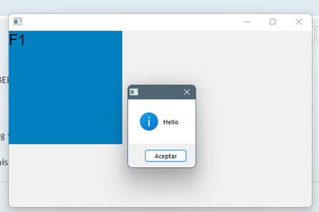

Re: Touch Screen : BUTTON, IMAGE and LABEL
AUGE_OHR wrote: Wed Feb 16, 2022 4:58 pm hi,
i have use Form Designer to create Code for LABEL
LABELDBL.ZIP
please try to "click" on LABEL
it need DblClick to get MsgInfo() ... what is going wrong ... :evil:
Mol is right that it should only "One Click" but this Demo does not work that Way, why :?:
The demo works with one click...
