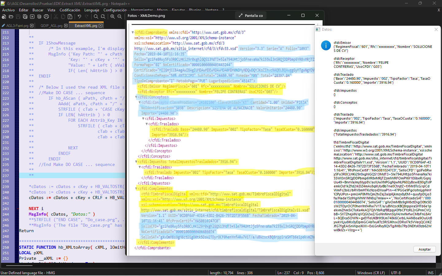

Re: how XML extract tags, keys
Hola EDK
Muchas gracias por tu aporte, le veo mucha utilidad.
He estado haciendo pruebas pero ya me perdí, y "necesito una una pequeña ayuda de mis amigos". :)
Los datos que están en Amarillo si los puedo obtener pero los que están en Azul no logro hacerlo.
Trate de hacerlo con el DO_CASE que genera tu ejemplo pero tampoco resultó.
Alguna idea ?
Hi EDK
Thank you very much for your contribution, I see it very useful.
I've been doing tests but I'm lost, and "I need a little help from my friends." :)
I can get the data that are in Yellow but the ones that are in Blue I can't.
I tried to do it with the DO_CASE that your example generates but it didn't work either.
Any ideas ?
Pueden agrandar la imagen abriéndola en otra pestaña.
The image can be enlarged by opening it in another tab.

edk
Posts: 999
Post by edk »
At first glance it looks like some nodes have Nil values but have attributes and child node. Those with Nil values are ignored, so we will have to treat them as if they had empty values. I'll try to prepare something tomorrow.
brunellopulix
Posts: 80
Joined: Sat Apr 24, 2010 10:17 am
Post by brunellopulix »
This is the attachment
